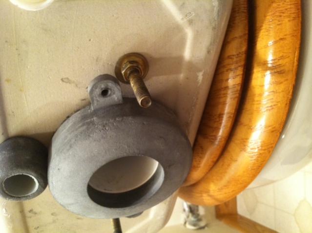

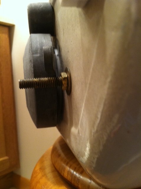

    Have a Briggs 4400 Vacuity toilet that was leaking between the inner plastic chamber and the porcelain tank. Called Briggs and they sent out the gasket (flat piece with four holes) and I installed that. However when I had it apart, all the other seals were worn and I thought I should try to replace them. Found a Plumb Works brand, Extra Thick Gasket and Bowl Kit (label says fits Briggs Vacuity Toilet tanks), part number: 664-1315.
    However, I can't get that gasket to physically fit over the base of the tank.
    It was installed in early 2004, has a manufacture date stamp of July 2003. Started to have the issues where it ran every 10-15 minutes, replaced the flapper and that seems to have solved that issue.

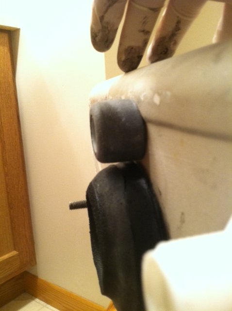

    Being a noob at this, I didn't think to take pictures as I took the system apart, but does the gasket with the two flaps sit flush to the base of the tank, or over the nut/washer? I know the gasket goes over the bolt, but wasn't sure if I put the "ear" on before or after the washer/nut?
    Here is the original seal, that easily fits in place, but it's worn.Name:  photo-1.jpg
    I've just come across this forum, does this project look like something that is better off with a new toilet (and not a Briggs?).
    I've seen the 1-piece toilets, I can imaging these type of issues aren't a concern (seat/tank and fitting/sealing), but are there other drawbacks to the 1-piece?
    I've read about the Toto, but being budget conscious, and not having a local dealer, are there brands that "prove the test of time?" Not opposed to a 2-piece bowl, but would like some feedback on the 1-piece.
    Thanks for any input on either the continued repair of this toilet or the suggestions to replace it. It's been having the dreaded "multi-flush" as of late too. Maybe time to throw in the towel on this one?
    Last edited by harringg; 10-01-2011 at 08:59 PM. Reason: Images aren't lined up with text. The original seal is the one with the hand in the picture.

    Never mind. Bought a Kohler Cimarron 11813-0 Class Six for under $250.00. Will return the parts I bought for the Briggs and apply towards purchase of new toilet. Needed something working before Monday.
