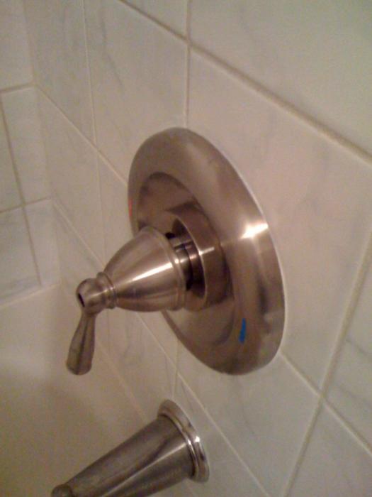

Shower handle sticking out too far
There are NO shorter trims, only extensions if the valve is mounted in too far. To recess it, you'll need to move the valve.

I have the same problem, and after much yelling and swearing, I think I found an easy solution.
You can buy a piece called an ESCUTCHEON EXTENSION (the one I bought is made by Moen). Do a Google search for the term and you'll find some distributors (the piece I found is called a Moen Escutcheon Extension 162 - Chrome).
The Extension piece fits between the finished wall and the escutcheon plate, and pushes the escutcheon plate 0.5" from the wall. When installed, it should just look like the escutcheon plate is extra thick, and you will have swallowed up 0.5" of space between the handle and the plate.
I saw that it came in 4 different finishes, and the one I found fits all 7" Moen single-handles.
Once I recieve the piece and install it, I'll post a photo.

Add me to the list of victims of the Moen shower kit from Home Depot (82910 Banburry in my case). The walls were out when it was installed and I now have it covered with drywall and tile. The gap is at least an inch.
I think the take home message is please avoid this product.
No, the answer is to understand the installation instructions, and trial fit the trim if you aren't familiar with the thing prior to determining where to place the rough-in valve. This is something a pro learns early on, and a DIY'er may have to learn the hard way. Depending on your wall finish - tile, fiberglass, solid-surface, etc., the depth will differ. From the manufacturer's perspective, it the trim fits, it is acceptable. Personally, I don't like it sticking out at the maximum, but it's not 'wrong', as it is fully functional.

I seem to have this same problem of too much handle shaft showing when I trial fit. I have not tiled yet, but I cant move the valve back due to obstructions. Would a double layer of 1/2" hardibacker work?
Has anybody tried those Moen escutcheon extender rings, and how do they look and work?
A second layer of cbu would work but it may mean some asymmetry you'd have to live with. All of the extender rings I've seen were to allow trim to fit if the valve was too far in the wall, not too far out. Not that they couldn't make one that would work that way.

So I realize this thread has been going on for a couple years now, but I also ran into this problem. I didn't rush in buying the Moen extension plate. I instead went over to the local Home Depot and just started walking around looking for anything that I could mount on the front or back of the mounting plate and with a matching Satin Nickel finish.
In the faucet repair isle I found a satin nickel lavatory mounting ring that worked quite nicely. Using some adhesive caulk, I glued the included rubber washer to the mounting ring and then the ring to the mounting plate.
The end result looks better than what I would have achieved with a correct install.
