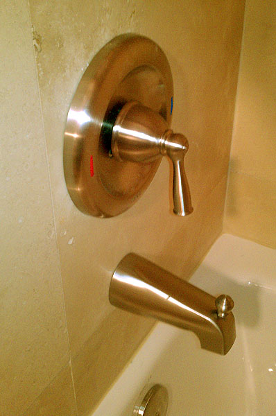

    Quote Originally Posted by Daydream46 View Post
    Just to illustrate my husband's (alphonse55) point...
    This is what our shower currently looks like....
    this can't be right
    From your post in 2007 I find it funny that I ran into the same problem in 2012. Moen simply sucks. They know that they have this probem and they continue to sell the same junk with the same problems. In south Florida most upscale homes are made with concrete block and stucko with a 1/2 inch nailer, sheet rock then tile (wood is bug food down here). Installed the product per Moen instructions more or less just diagrams.
    So when installing the same shower valve five years later I have the same problem and it looks like hell. Pure junk. Moen answer move the valve back to allow the handle to be flush. Oh, you want me to take off the tile, sheet rock, knock a huge whole in the concrete block and change the plumbing just so your junk will be flush. You got to be kidding me. Moen plan B we will send you an extention for the plate that will give the tolarable distance of 3/4 of an inch. Give me a break. Moen shower handle sticks out and looks like crap.

    Moen (and most other manufactuers) give a range of acceptable fitment for their valves. From their viewpoint, if it fits, it's okay. But, since there's a range, it is up to the individual to decide where THEY want it. SOrt of like deciding where to hang a picture...not everyone will like it in the same place. YOU have to try it and decide. The manufacturer is just telling you the range in which it will fit. It's always best to mock up the wall configuration and valve placement to decide if it's the look you are after. If not, and you can't change the valve placement, choose a different brand that may have a different set of limitations that meet your criteria of acceptable asthetics - don't blame the manufacturer on this (although they are not blameless maybe for not telling you).

    I have never cared much for the Moen line myself but in order to not make this a "I hate Moen thread" will say that having the trim onsite with the rough in is key to nailing these installs. I'd class Moen in with a huge class of what I call Low End fixtures. These low end fixtures offer a good price and cheap replacement parts. Easy to service. Fast to install. Cheap. Cheap. Cheap.
    Higher end fixtures like my favourite Dornbracht ones offer up better design, better site sizing, better leak protection and on and on. The difference is in the install and how the trim is installed.
    With some fixtures great effort is needed to achieve a certain look. Perhaps the backing for the Moen shown above was installed as a 2"x10" - perhaps using some 3/4" plywood would have made this install look that much better.
    Sometimes its crap in the wall. Maybe the collar is not fully sitting back into the wall???
    If you leave these types of choice to the plumbers - you get what you get.

    Here is the same valve as above. A Moen Posi-Temp. I just trimmed this out today.
    I like the fact that there is a range that the valve can work at. I'm not a big fan of tearing things out when the surround that gets installed is either too thin or too thick. Moen is pretty hard to screw up. Even if it's set too far back, it's doable.
