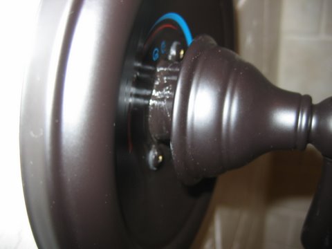

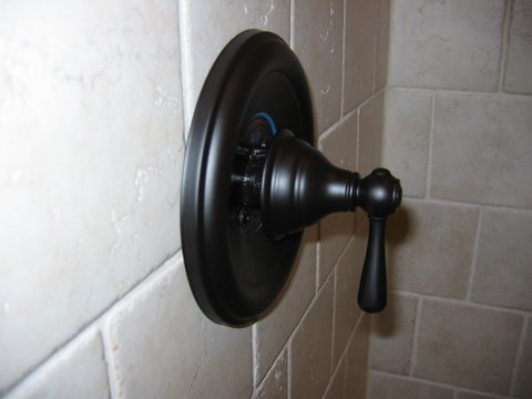

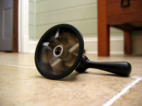

    Default My Valve Is Out Too Far Too!
    This thread may have saved my butt.
    I have the same problem alphonse55 and Daydream46 have. My plumber probably didn't read the installation specs and mine is a Moen as well. The valve sticks out such that it leaves about an inch gap between the handle and trim plate. I was thinking there was no way to fix this without ripping off my newly tiled wall and repositioning the valve. But then I saw this post...
    Here are two pictures of mine, below, after applying the same workaround (i.e., using the Stop Tube to bridge the gap). I added rubber washers to the screws since they will be exposed now. Also, the shiny stuff around the Stop Tube is fresh caulk. I added the caulk because I didn't trust the weak little gasket where the trim plate meets the Stop Tube.
    I have a question, though, about the black tube (spans gap between wall trim plate and handle) referred to as the "Stop Tube Kit" in Moen's specs. According to the Moen manual, http://www.moen.com/shared/pdf/instr...ts/INS795C.pdf, (see step 6), the tube thingy, part B, is supposed to be used if the valve is too far back into the wall. But in this thread, it was used to fix a problem with the valve being too far out of the wall.
    1. What is this piece truly intended for?
    2. If it was meant to be used back inside the wall why would its finish match that of the handle? In other words, it certainly looks like it was designed to be seen, not hidden.
    3. Finally, many people on this thread are saying this is acceptable. When I look at the wall side of the handle piece (see 3rd picture), I certainly can't believe Moen designed it to be away from the wall in some installations. Am I missing something.

    Ha! Are you saying it was my responsibility to tell my plumber to rough-in the valve so the handle could attach like it says it should in the instructions? Like Moen shows in EVERY picture? That is ridiculous. Shouldn't the plumber figure that out on their own. Especially after being given all the trim pieces and the installation instructions. They're the experts on this stuff.
