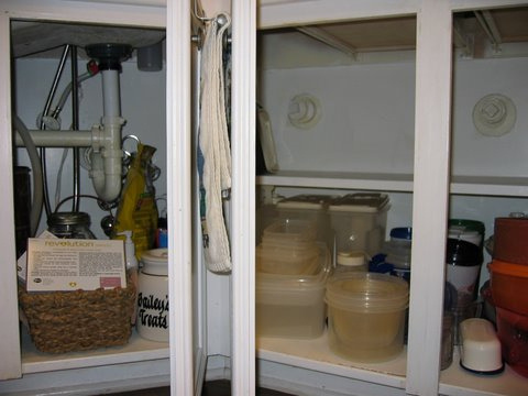

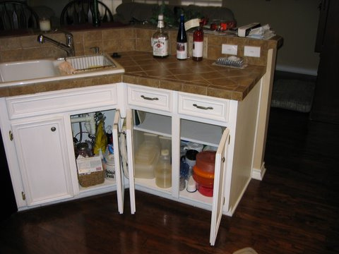

    I took a few pics to help clarify.
    Pic #1 is the sink as a whole. The other fixtures in question are to the right.
    Pic #2 shows the sink p-trap and two, just discovered today (thx winslow), cleanouts (foot vent?) in the cabinet to the right.
    Should I snake these? both directions?
    What are those exactly and where do you think they fit into the equation?

    In the right picture above if I remove one or both of the cleanouts the sink doesn't make a sound when any fixture mentioned above is operated. I snaked each one with negative blockage or even moisture. I could not get far going up though (18"). Shouldn't these be conected? I was trying to get the snake to show itself in the other cleanout but no luck.
    When I put a piece of tissue over the cleanout hole and I flush the toilet it initially moves out (blows air) then sucks in (sucks air). After a large initial movement each way it oscillates back and forth as it "equalizes." I hear the gurgling sound in the pipe (faint and distant). No smell present.
    Sidenote: The toilet in question has been hard to flush at times. We initially thought it was because it was an older low flush model. BUT...when the cleanout caps were off it flushed easily every time. Caps back on... noises returned.
    What does this suggest?

    FYI...I was finally able to snake the top of the island vent loop and it does indeed connect. I have run 25' of auger down the right of the cleanouts with the occasional bend but no blockage and dry to 25'. On the left cleanout I was able to run about 15-17' before it stopped. I feel it was a 90 turn or the like and not a blockage since the auger tip came back clean.
    Am I right in assuming (look at picture) the right cleanout (should) goes to the vent pipe and the left (should) be the drain line?
    My sound test above would make you think the vent line portion of my island plumbing is blocked or it was not vented correctly in the first place. All exposed plumbing looks correct to me here and in the rest of the house.

    Quote Originally Posted by FlyBoyd
    Yes. However, the system still won't work if the plumbing beneath the slab isn't done correctly. That's something that you cannot determine easily. Still, there's no reason that I know of to suspect that it isn't correct, other than the gurgling problem.
    Does it make any difference which sink you're draining water from when it gurgles? Can you run a hose down each of the cleanouts?
