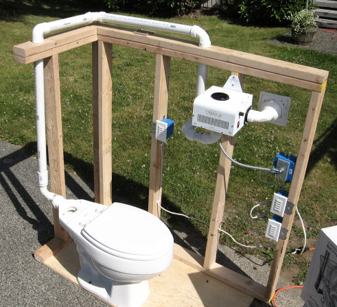

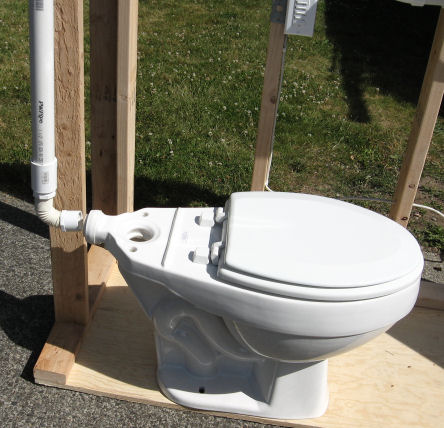

    Here is a vented bowl for the bathroom to reduce smell.
    There is a remote fan, with piping to the back of the bowl to suck out the smells from the bowl.
    Shown with controls and fan.

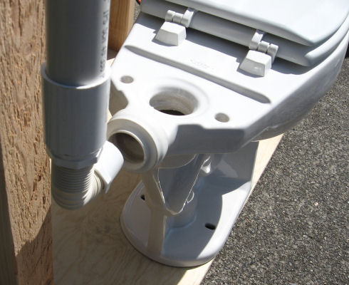

    The connection at the back.

    The only problem that he needs to address is the possibility of water building up from condensation in the vent piping below the fan.
    I would guess there is a market for it, albeit a small one.

    Wouldn't that be an interesting unit to rough in. We have enough problems trying to get a finish wall measurement for the shower, and now we would have to know EXACTLY where the finished floor would be so the vent opening could be positioned, AND THEN try to fit that thing onto the vent and the closet bolts, while not damaging the wax ring. Maybe it is made of plastic, so at least it would not weigh half a ton.

    The final connection is behind the tank. A small hole in the drywall, and a flex connector goes to the back of the bowl.
    For condensation, the connector should grade down toward the bowl.
    The extra switches are for extra bathrooms. All bathrooms could be piped to the same fan.
