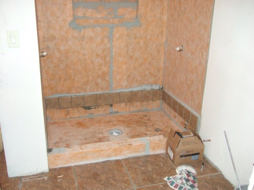

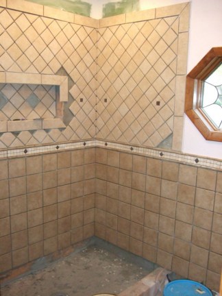

Fiasco
43
My preference is to do the walls first. I find the lowest spot in the floor along thew all and snap a level line around the room 1 tile height above that point. I leave out the bottom row, set the 2nd row all the way around and let it setup completely before continuing up the wall.
I put the floor in next and the lowest row of wall tile in last.

Do you use a ledger board fiasco. If so how do you attach it in a non-Kerdi shower or was your comment just about Kerdi showers?
If you don't use a ledger board how do you keep the tiles from slipping?
Where there isn't Kerdi I use a board. Inside the shower I stack tile in each corner to the appropriatte height, set a ledger board on top of that and shim it to the correct height.
I set a single row of tile around the room. I use painters tape to help secure the bottom row of tile taping it to the wall above. I then let it setup and don't lay more tile above until the next day. If you get a perfect home row it just makes the rest of the tile job so much easier.
