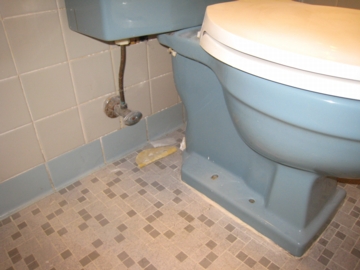

    I'm replacing my 50+ year old original toilet with a new EcoDrake model. There is no center bolt on this old toilet. Can anyone make some guesses about what issues I might face once the toilet is removed ? There is an old iron waste pipe (the house is up off the ground - pier and beam) below that was in good shape last time I had someone look.
    I can hire a plumber if need be, however the handyman is going to do a lot of work on the house in the next month - so it seemed easier to have him include it on his list.
    I've attached an image of the bottom of the present "Standard" toilet.

    It's the back set of bolts on the bowl.
    That should be centered on the drain.
    The Eco Drake will need 11-1/4" from the finished wall to fit.
    If the drain is 4", you have some wiggle room.
    Did they glue the bowl down?

    Yes, the bolt hole closest to the wall is exactly 11 1/4", so it should just fit. I have no idea if they glued the toilet down. Unfortunately, this is a one bathroom house.
    I was wondering about the 11 1/4" measurement to the back bolt and knew I might need a different rough-in than the standard 12" - so hopefully the EcoDrake will fit. The plumbers I spoke to over the phone didn't want to come look for a fee - they just wanted me to hire them to do the job and none had any idea what I was talking about when I told them the 11 1/4" measurement to the back bolt.

    I bet the reason the bolt holes are 11-1/4" from the wall is that the plumber who roughed in the waste line didn't know that there was to be a tiled wall behind the WC.
