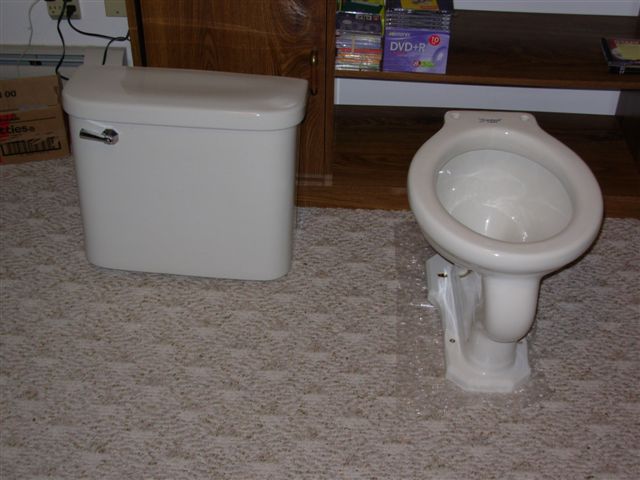

I have a question for you vintage toilet experts. I happened upon a vintage toilet still in use a while back with the forward-facing trapway. It had a siphon jet and large rim jets at the back of the bowl, rather than the front, and a small waterspot much like today's low-flow designs. I was struck by how logical this design seemed from a flow standpoint. It's a much shorter distance from the tank to the jets lined up with the opening of the trapway than on today's nearly universal reverse-trap designs. Could someone tell me what advantages the reverse-trap has that caused the forward-facing version to be abandoned years ago?

When I was in college, and that was over 30 years ago, there was a large series of books in the library authored by a group of sanitary engineers. I cannot tell you what that series was, but it dated from the early 1900's right up into the 1970's. The professionals in this group may know what I am referring to. I do recall reading in one of these books that the washdown bowl such as you describe was deemed unsanitary and no longer made, around 1968 or 9. It was because of the small water spot and the large area of porcelain not covered by water, particular the area in front of the bowl that slopes down to the water thus making the bowl more susceptible to staining. I do recall seeing washdown toilets in hardware stores (Gerber, Sears (which were made by Universal Rundle), and in plumbing shop display windows (Eljer)), but they suddenly disappeared around the late 1960's.

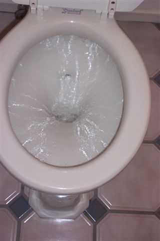

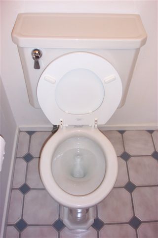

Below are some photos of some action shots as performed by my 1936 Standard MODERNUS in my home and by my oldest, a 1926 Standard TIFFIN in my cabins outside half bath.
In both bowls, you can see the smaller water spot and the sloping surface of dry porcelain.
The newer MODERNUS has the jet at the back of the bowl and a thorough rinse from the rim jets. The flush is fast and complete, every time. This bowl was redesigned later on and the newer design is a bit deeper with a larger water area. But I like the older design better. The only problem with the MODERNUS is that it's easy to stub your toe on its base at the front, and it hurts!!

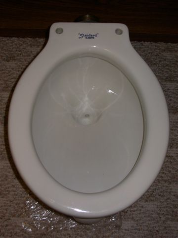

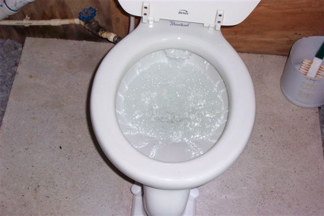

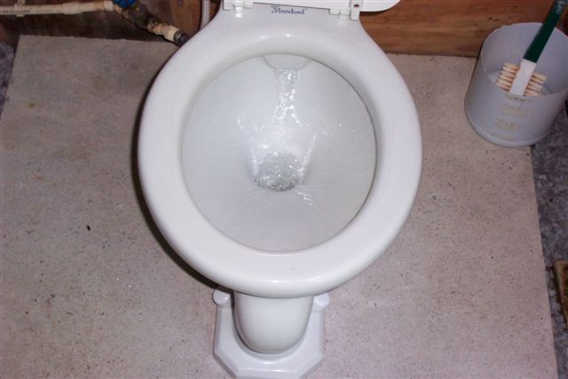

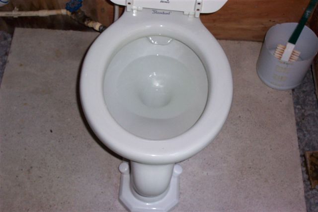

Lastly, here are some shots of the older TIFFIN. This one has a large jet built into the rim and none at the bottom of the bowl. The bowl also refills from this spout. This bowl later evolved into the Standard EJECTO. I have one made in 1929. It's based on the design of the older TIFFIN (and still has TIFFIN stamped into the back of the bowl), but the spout is gone and replaced with a jet at the bottom of the bowl.
I hope I've helped to answer your question.

ACTION SHOTS: 1936 "Standard" MODERNUS followed by 1926 "Standard" EJECTO

The front discharge toilets were called "washdowns" for a reason. Most of them did not have a jet. They flushed by filling the bowl with water and then the weight of the water created the flow which flushed the bowl. Which is the same thing we do when we dump a bucket of water into a bowl to see if it will flush.

The photos that I sent earlier show that the 1926 bowl in my shed does exactly what HJ describes. You can see the bowl filling with water, all from the rim (and it should have been a higher, I shot that photo just as the water started to go down), then emptying. That projection in the rim in back must be some sort of a primer. As a kid, I thought it was only for show!!
Here are photos of how this bowl evolved. The "Standard" bowl below is made in 1929, and is a modified version of the 1926 bowl above. The projection (or spout) in the rim is gone and there is a jet at the bottom. The base is also slightly wider. Both bowls have the name "TIFFIN" stamped in back, but the newer version has been renamed "EJECTO", and whoever came up with this name had a wonderful sense of humor.
New info: The bowls mentioned above are actually two generations of the "Standard" EJECTO. The jetted version appeared in 1928. TIFFIN refers to the plant in Tiffin, Ohio where the toilets were produced.
