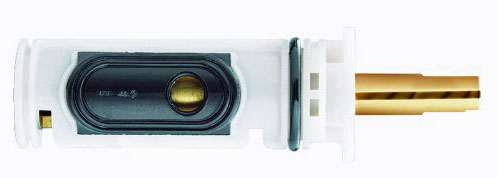

    The single handle bathtub fixture broke off yesterday. I pulled the cover off and managed to extract (it was pretty difficult!) the broken cartridge. I got a new assembly from HD and thought it would be pretty easy to install. However, I can't get the new moen cartridge in all of the way! Am i missing something? The old cartridge was numbered #96909 (or 60696). I can't find a direct replacement, but that wouldn't help because the handle itself broke too.
    Also, would it be easier to just go with another brand? Will they work with the plumbing fixture pictured below? In the pic below, the new cartridge is in (but not all of the way).
    Moen replacement 1222 for the Posi-Temp Shower Valve

    You need to return the junk from HD and go to Low*s and buy an OEM cartridge.
    The other thing is look inside the valve with a flashlight, and be sure there are no peices of rubber inside.
    You can also put a thin coating of silicone onside the valve B 4 U install it, it should come with the new cartridge, if it doesn't you can buy some.

    I looks like the tabs on the cartridge are not lined with the slots on valve body.
    Twist cartridge with pliers and gently push at same time. This might work.

    First there is probably no valve out there that is easier to work on than what you have. Pull the cartridge back out and make sure there is nothing inside the bore of the valve. Grease the cartridge and push it in.
