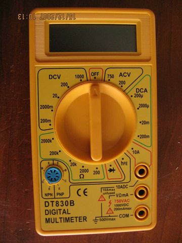

I just got a digital multimeter, the first one I've ever owned or touched, for only $10, new!
Great stuff. But it came without leads. And when I look at it I see not two holes marked + and - as with my old analog meter, but three, with strange markings.
So I don't know what to put in where.
Could someone please help me? I've attached a pic.

Common and the hole right above common, the bottom two holes, third hole upper most is for measuring amperage utilizing the meter in series with the load and source.

Make sure not to connect the meter ACROSS a voltage source with the COM and 10AMP leads, as that is pretty much a dead short.
The blue socket on the left is to connect the three leads of a transistor ( 2 types, NPN and PNP)

Okay, got it. I use the bottom two holes. The bottom one is negative and the middle one is positive, to use my old analog meter terminology.
The 'COM' marking threw me. I didn't think of 'common' as an answer. And I still don't really understand it, but okay, earth, neg, like that.
DON'T use the 10ADC and COM across a voltage source. Those two are to be used in series when measuring amperage with a hefty 10Amp maximum. Well, sounds hefty to me. I've never ever before measured current but I guess I'll be bound to have a go now I've got an instrument.

"banana plugs" are what will fit in the test meter connections. Pretty much standard issue for test leads.
