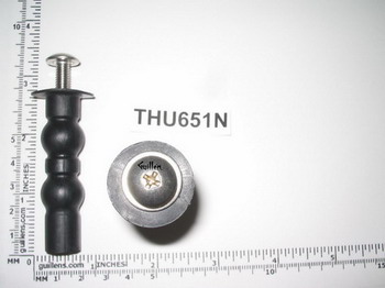

    Default OK, I think I may have found something....
    Yes, I have been looking for over two years off and on. However, I think I may have found something that will work.
    (I tried Home Depot's in Orange County, CA and they don't have the normal expansion plugs. In fact, they were quite rude when I showed them a printout from an earlier post saying Home Depot had them.)
    What about these?
    Part Description:
    TOT THU651N TOP MOUNT SEAT HARDWARE FOR SKIRTED TOILET | THU599; THU615; THU510; THU651S
    http://www.guillens.com/index.jsp?pa...&text=THU651N#
    It looks like something that might work. Although I can't seem to find the actual specs on the pieces.
