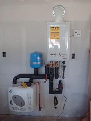

  6. #21
    DIY Junior Member gmt's Avatar
    Nov 2006
    Pennsylvania
    26
Size:  26.5 KB Here is one installation. It is installed as per Rinnai specs.
  7. #22
    GMT, thanks. The picture helps a bunch. Please see the attached. I want to make sure I completely understand the plumbing. I have labeled the pipes. Let me know if my assumptions are correct.
  8. #23
    Nov 2006
    Pennsylvania
    26
    Boy that picture is big!
    That's pretty much it. Just go by the diagram (Noritz/ Rinnai) whatever and install the check valve where it says.
    My advise is to stick to one of the big three manufacturers...Rinnai, Noritz or Takagi. I believe all three have somewhat similar systems
    Good luck!
