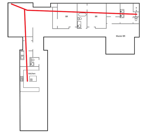

This is getting a little more confusing than I thought.
My new house is a one story "L" shape with 2 Baths on one leg of the "L" and a Kitchen + half bath on the other leg of the "L".
As I mentioned earlier I have a 3" vent penetrating the roof at each leg of the "L". I really wasn't planning on having any type of soil stack. What I wanted to do was run one long 4" drain (see attached) and vent each fixture with the appropriate sized vent. Then connect them all in the attic and finally attach them to the 3" pipe I already have going through the roof.
I've added up each of the Fixture Units and if I'm reading my tables correctly I think I would need to convert to a 3" vent pipe after I've picked up more than 8 fixture units since my vent pipe in the attic would run horizontally. Right???

I knew I was going to run a 4" building drain so I figured I couldn't go wrong with two 3" vents. But now that I'm running the pipes and connecting to these 3" vents, I'm wondering if I need to make one fixture have a 3" vent and then connect it to the "existing" 3" vent through the roof? Or (as stupid as it sounds) run 2" and use a pipe increaser to connect it to the 3" at the roof line?
My code (UPC) says that a vent pipe can only be run 1/3 of it's total permitted length in the horizontal. But, if the vent is up sized by one pipe size, it's entire length, that no longer applies.
So, if the minimum vent required was a 2". the maximun length would be 120' and only 40' of it could be in the horizontal. If more than 40' is needed horizontally, it would need to be upsized to 2.5" or 3" for it's entire length, horizontally and vertically.

I would reduce each vent before it goes through the roof with a 3x2 san tee and a 2" bushing. I would then tie in one bathroom to one of the 2" connections, Then combine the kitchen and laundry and tie it into the other 2" connection. I would do basically the same thing on the other side, run one 2" vent up from one bath and tie it into a 3x2 before it vents thru the roof. Then run another 2" vent from the other bath into the 3x2 san tee. According to the UPC you can put 24 fixture units on a 2" vent and run it horizontally a maximum of 40 ft. The 8fu limit is on 2" horizontal drainage piping, not vent piping. SO you only have to run 3" in the attick if your horizontal piping goes more than 40 ft.

In the IPC 910.3 it says a stack vent shall be provided for the waste stack. The size of the stack vent shall be not less than the size of the waste stack.
If this is a single story house then it won't have any waste stacks. A stack vent is just a continuation of the waste stack up through the roof.
