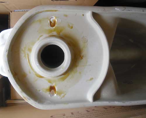

    Terry, in your opinion is the Kohler Highline with pressure assist better than the Gerber Ultraflush for my situation?
    Yes.
    The Gerber has only a 1-7/8 opening as the trapway exits the bowl.
    The Kohler has a larger trapway.
    And don't tell me that the Gerber specs mention an average of 3". Someone was smoking pot when they wrote that. You can't fool a plumber. We carry tape measures.
    The Gerber's 1-7/8" trapway exit.
    Super large 3" trapway on the Caroma 305 bowl, an inch larger then everything else.

    Sorry to bother you with so many questions but I just wanted to ask you a couple more things. In the Caromas, is the exit hole in the bowl as big as the trapway? Also, a few people mentioned having to drill holes in their bathroom floor in order to install their Caroma and I was wondering what that's all about?
    Caroma's usually use a flange adapter that you set the toilet onto then fasten it down with 2 screw holes at the back. I always silicone them as well as the screws don't hold it in place that well. The 305 doesn't use that adapter so if you go with it you will be fine.

    If you have a problem with the Caroma trapway, it will be the first. I would be amazed.
    Do you think you are that amazing?
    270 bowl uses an adapter that mounts with standard closet bolts, and two screws at the back of the bowl.
    305 uses the standard closet bolts at the flange.
    I caulk the bowls to the floor when I'm done installing.

    The advantage of a larger diameter trapway is that a stick can go around the curves better. I doubt there is any human that could create a stool large enough in diameter to not make it through a typical toilet...but, when you add in the fact it is long and hard, you need that extra diameter for it to navigate through.
    A pressure assist was discussed...I'm not sure that would make much of any difference except add costs and maintenance (not counting the noiser flush). If the trapway isn't big enough, until the stool has a chance to soften by sitting in the water, it's not going anywhere.

    If you have this guys problem, I don't recommend a gravity except the Caroma. A medical condition means that most products aren't going to cut it. The Kohler pressure assist is also a good option if you have medical issues. It's about $450

    Thanks Terry, I'm really thinking of giving the Caroma a try. Do you know if the hole in the Caroma bowl where the waste initially passes through before it enters the trapway is the same size as the trapway or is it smaller?
