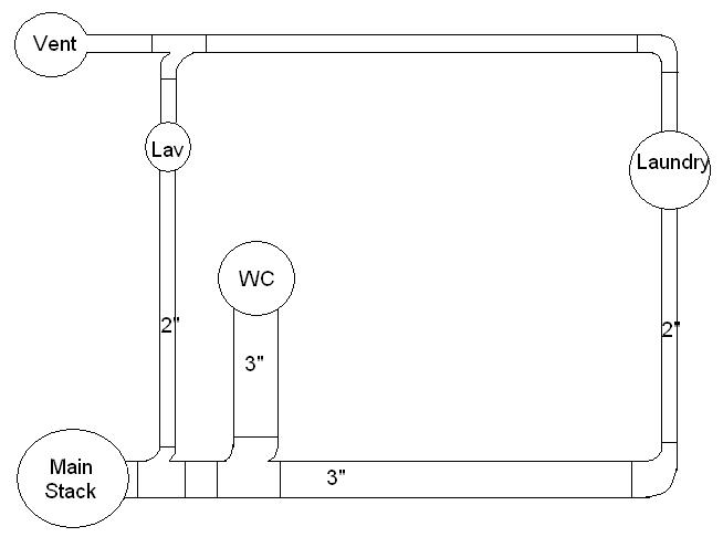

Okay, I've been watching this forum for awhile, and many questions have been answered. I haven't seen my particular question. I am doing a bathroom with laundry in my house. I get a little confused with the venting requirements on the toilet and how to connect it into the waste. The sink and laundry drain and venting, I get. I'm doing those based on a lot of post reading. However, because I don't want to cut into my nice 10x2 joists, I was hoping to not have to vent the toilet. It is within 6' of the venting, as this is a small room. But would I have to worry about the solid waste causing a problem as I enter the main stack?
Attached is a pretty crude drawing, the sink and laundry are vented/drained properly. I'm just concerned with how the toilet joins up and is vented. The whole room is 7' x 10'
Thank you so much!
-Rob

It is a little of both. I don't have the fancy software and I stink at drawing.
For the WC, it will be a 3" long sweep headed downward. The washing and sink will be a 2" long sweep and will be vented.
The part I'm having confusion on is where the toilet, sink, and washing machine drain meet. Both the sink and washing drain are vented, I'm hoping to get away with not venting the toilet.
I'm now thinking it might be best of I have a + shaped 3" fitting with two 2" sanitarys coming into it from the sides.

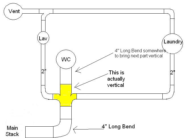

So I was stuck in traffic for an hour, and this is what I came up with. The part I wonder if I'm okay is in yellow

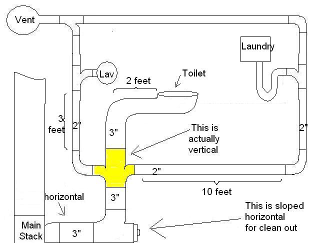

I changed my image above. I have to get started tomorrow, does it look okay the way I have my waste coming together and not having my toilet vented?
Herk
545
S.E. Idaho
No. I wouldn't claim it or expect it to work. I don't know what the codes are like in Missouri, but here you'd be told to rip it out and start over.
You have to vent the toilet. I'm unclear as to why you don't want to drill a 2" x 10," or why you don't want to vent the toilet.

Good point, just laziness on my part I guess. I had read that toilets didn't need as much venting since it was so close to the main stack.
Can I vent with a 2" pipe if the drain is 3"? Would I just have a 2" coming up off the 3" drain?
Patrick88
832
Webster Ma.
Yes pull a 2" vent for the toilet

So I'm okay with the 3x3x2x2 wye sanitary +?
I think this will work, I'll post real pictures as I go, since this is pretty simple.

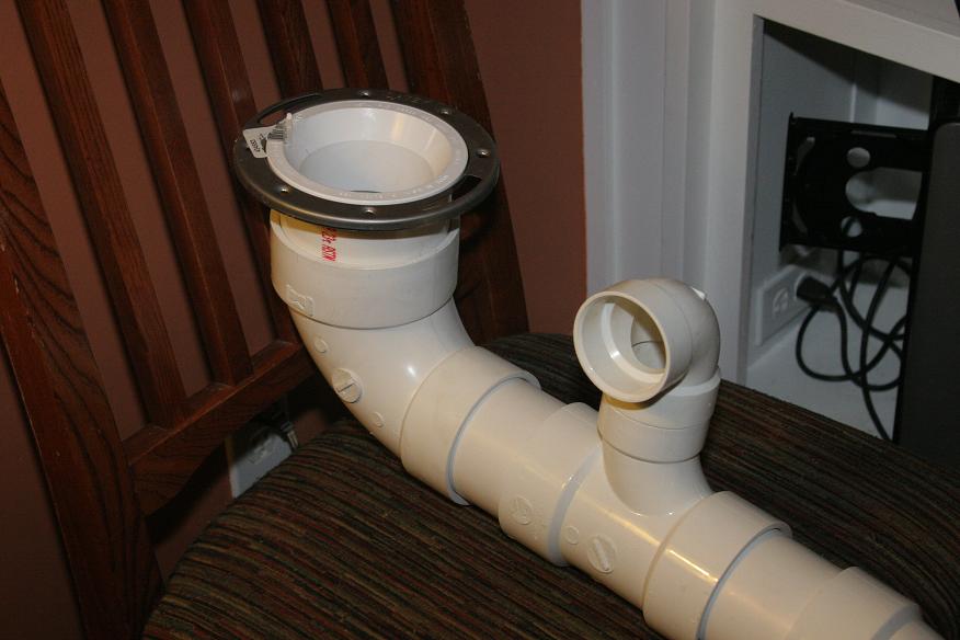

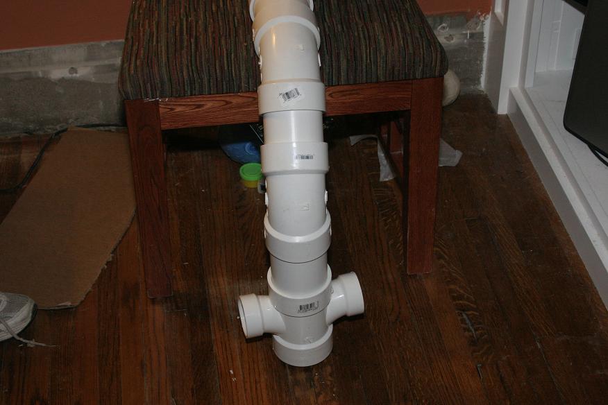

okay, here is the dry fit for the interesting part... Do I have the right fitting (going the right way?) for venting the toilet? All I could find was a sanitary fitting.

I turned the T, so the "gas flows up".
What is wrong with the cross? It is just before it hits the main stack. My main is cast iron and someone already linked the 3" PVC into it, and I'd prefer not to have to bust into it for a second connection.
That's a good one! Don't know who told you that!
This project is an excellent example of the old proverb..." the devil is in the details". You have laid out a bathroom drain system which seems to make sense. Unfortunately, you failed to consult a plumbing code book. The size of piping is incorrect for a wet vent, the fittings are wrong, etc. A sanititary tee cannot be used on its side. A sanitary cross usually is not accepted in the usage shown. You would probably have to increase all the pipes to 3". Etc.

Would a cross with the Y type arms be acceptable? I did know that the sanitary shouldn't be on its back, but how else could I vent the toilet?

Ok, new plan. How does it look to you guys?
Just noticed I have the toilet vent going the wrong way, but otherwise?
