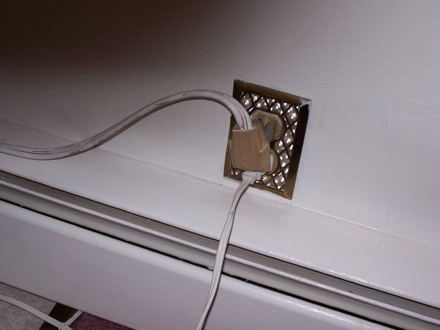

I need to install a garbage disposal, but there's no outlet under the sink. The closest outlet is to the right of the dishwasher. You can see from pic 1 that the dishwasher is plugged into the top of this outlet.
I offered to tap into this outlet and install a toggle switch a few feet above that would only work 1/2 the duplex (after removing the connecting tabs).

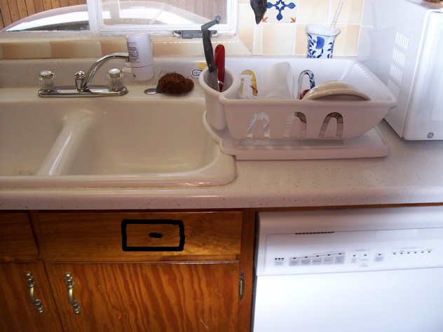

The homeowner nixed this, saying that her arthritis wouldn't allow her to walk the extra few feet to turn the G/D on and off. I offered to have the switch be above the sink, but she nixed that, because I would have to tear into a lot more of the wall and remove some tile.
The only thing I can think of is to splice into the appliance cord and install a toggle switch that sits in a box that I'd put inside the dummy board under her counter (see pic 2). Is that up to code?
Also, do they make an appliance cord with a toggle switch already built in?

I see an unused opening to the right of the faucet. Why not get a air switch and turn the disposal on from there?
Air Switch
Let me guess.... the duplex in the photo is not grounded. If it isn't, DON"T USE IT! I would first check the dishwasher circuit. If it is grounded, then use that instead.

(BTW: I'm no electrician, but that outlet scares me. Thats a big cord w/cheater plug.)

If none of the outlets are grounded in that old house, is it still against code to plug in a garbage disposal?
I'm sure they've plugged in hundreds of appliances over the years in those ungrounded outlets.

Yes, it is. The manufacturer's installation instructions rule, and they always require grounding.

How's about I install a GFCI there and get rid of the ungrounded receptacle and 2-3 prong adapter. That way, at least the DW and G/D will be protected and maybe more, depending on what's downstream in that circuit.
This would be the simple solution
406.3(D) (3) Non–grounding-Type Receptacles. Where grounding means does not exist in the receptacle enclosure, the installation shall comply with (D)(3)(a), (D)(3)(b), or (D)(3)(c).
(a) A non–grounding-type receptacle(s) shall be permitted to be replaced with another non–grounding-type receptacle(s).
(b) A non–grounding-type receptacle(s) shall be permitted to be replaced with a ground-fault circuit interrupter-type of receptacle(s). These receptacles shall be marked “No Equipment Ground.†An equipment grounding conductor shall not be connected from the ground-fault circuit-interrupter-type receptacle to any outlet supplied from the ground-fault circuit-interrupter receptacle.
(c) A non–grounding-type receptacle(s) shall be permitted to be replaced with a grounding-type receptacle(s) where supplied through a ground-fault circuit interrupter. Grounding-type receptacles supplied through the ground-fault circuit interrupter shall be marked “GFCI Protected†and “No Equipment Ground.†An equipment grounding conductor shall not be connected between the grounding-type receptacles.

Run a new 12-2 circuit to the under sink location. Terminate it in a surface mounted box with a receptacle in it. Run smurf,flex or AC cable to the switch. Install a switch inside the cabinet under the sink so you will need to open the cabinet door to turn the disposal on. Make the switch convenient. Connect the wires so that one half of the receptacle is switched. The other half will be hot all the time so in the future the DW can be plugged into it. I assume your AHJ allows GD/DW sharing of one circuit. My guess is that the DW is also ungrounded. Air switch is an idea but you still have to run the air line and mount it to the wall.(same work as running wires) Also do not know if air switch is legal for a disposal.
