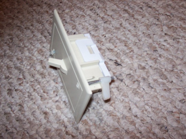

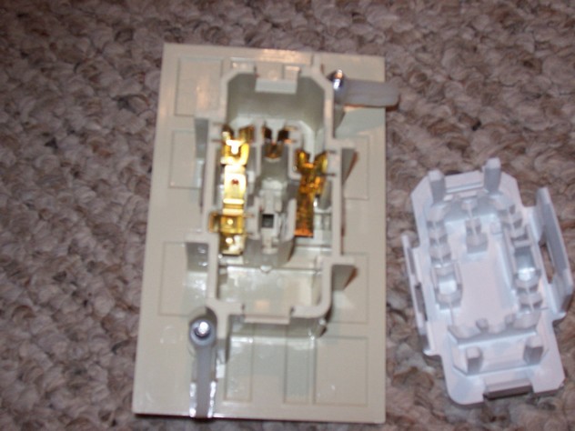

Anyone know the secret to wiring up a trailer lightswitch that comes in its own box?
I've been "practicing" with some 12 gauge romex, but I can't get the individual conductors to snap into the brass clips. Are these things made for 14 gauge only?

Try some AWG14 and see if it snaps in. If it does, I think you've answered your own question. Since it's a light switch, they probably assume the wiring will always be 14. Lots of "conventional" backstab devices will only accept 14 as well.

It should say right on it what type and gauge wire it will accept...
That being said, your pic is the first time I've seen the back side of one of those switches... Never dealt with those before.

It does say that it is rated for 15 amp 120 v. So, I'll have to buy some 14 AWG. to practice with.
It's similar to back-stabbing, but a bit different. The main difference is that I don't see a release button, so I might not even be able to re-use it once I figure out how to connect the darn wires.

Those special switches and outlets without a real box are sometimes all that will fit in the thin walls in those trailers. The cable is clamped between the two pieces of plastic and you don't need to meet any "box volume" requirements.
Looks like the rear half of the case pushes the wire down between the two prong-thingies that go through the insulation and contact the wire, much like communication wiring uses a punchdown block and tool. When you separate the back of the box from the front, you should be able to pull the wires out from the prongs with pliers. Whether the thing is reusable or not I can't say, but I reuse Cat5 punchdown connectors regularly, even the small plastic individual jacks.
Ca't really tell from the pictures, but it looks like the hard part might be pulling the two halves of the box apart -- those one-way snap-together pieces are a little scary.

That's actually easy. There's just a couple of tabs that you can pry open with a screwdriver. It's removing the wires from the brass clips that I'm worried about.
