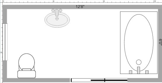

    <boring default layout>
    Here is a brain-dead (mostly) to scale design diagram of a functional bathroom space. I would like to do something more interesting and/or luxurious, but for now lets use this as a reference point.

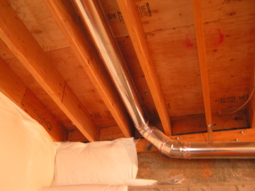

    <underside>
    Here is the new addition's basement area directly under the bathroom space. The joists are 2"x10" 16" on center. The heating vent is 1 bay over from the door, and is supplied from the crawl space of the existing structure.

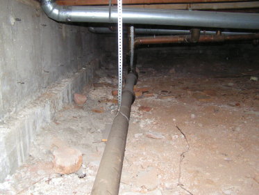

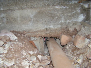

    <stack 1, 2>
    Here are some pictures of the existing waste stack. It is cast iron running horizontally under the foundation not more than a couple feet away from access of the previous picture (not counting 2 thick concrete walls, joists, and stuff).

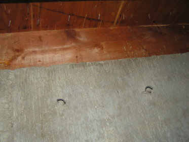

    <joists>
    Here is the first problem in search of a solution. I would like to avoid going through the concrete (want to finish the basement and then there are those 2 intimidating, thick, well-cured walls). Iím pretty sure that leaves putting a 3.5" O.D of schedule 40 through a 2"x8" joist.

    I would move the pocket door farther from the tub,
    If you plan on tile, or a glass door with frame, you will want some solid wood near the edge of the tub.
    If this is for the master, I would be thinking of two lavs, and keep the toilet on the same wall. Opposing fixtures in a room that is about six feet wide can be a little tight.
    Going through concrete walls is not hard.
    In a crawl like that, it's better to hang the pipes below the floor joists rather than drilling them.
    Getting someone in to core the walls is easy.

    1. On the pocket door. I agree and was thinking the same thing when I re-took measurements, but its kind of a done deal unless I want to rip it out. If I were to do that, I think I would just jettison the pocket door (they are more trouble than worth). For now, Iíll resist that option a bit more than the others.
    Kirdy might give me more options over the pocket door. Other than that, itís likely a compromise of which is the least invasive feature: the pocket door, or the egress/ventilation window.
    2. This layout is not optimal. Once I have a good DWV plan and know what is possible, I would like to spend a good amount of thought in doing a cool, highly functional layout.
    3. Re: going through the concrete. The more I think about it the more sense it makes. Who would I look up in the phone book. And out of curiosity, what tool do they use?

    I used a pocket door at the head of my tub/shower, but built it out with a normal 2x4 stud wall (so that wall was double thick). This allowed me room for the plumbing and a strong wall for the tile. Finding a wall cavity clear of outlets, wiring, ducts, or plumbing is often hard, so you are limited on where you can put a pocket door. Note, there are kits that put the door entirely on the outside, if that would work (sort of like a barn door arrangement) that wouldn't take up any interior wall space.

    For coring the holes, they use a diamond tiped core drill.
    "core drilling"
    with a little bit of water to keep the bit from getting too hot.
    That bathroom is so long, you might be able to put in a seperate room for the toilet at the far end.
    Or you could put in a vanity on the far end going wall to wall.

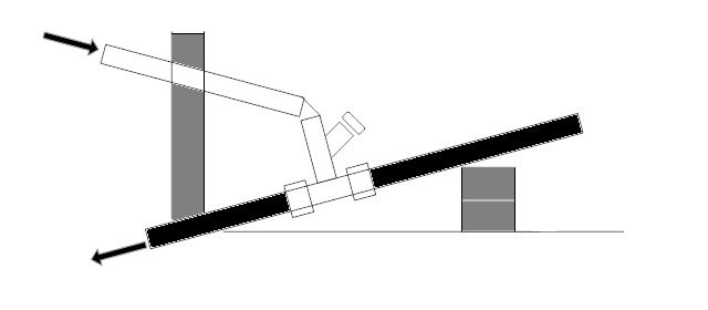

    Here is a very rough drain plan for connecting to the existing stack.
    3" Schedule 40 going through a >= 3.5 'cored' hole into the crawl space. New support for the cast iron will be provided near the snap points with some cinder blocks, a little digging, and a bit of mortar. A pair of poly/metal couplings marry the Schedule 40 to the cast iron + a standard waste Y with a cleanout .. use 45s whenever trying to make adjustments for pitch.
    Forgive the illustration I haven't installed the right drawing tools for doing a good job of this so the pitch and scale are way out of whack. It should serve well enough as an illustration thought.
    any refinements before moving on to the venting?
