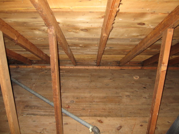

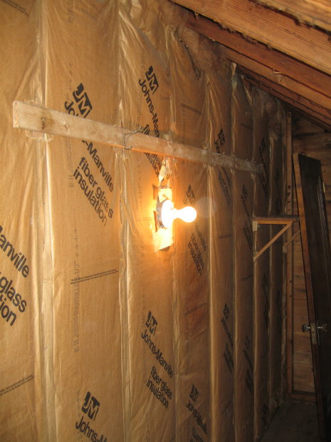

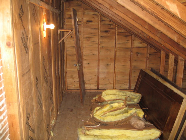

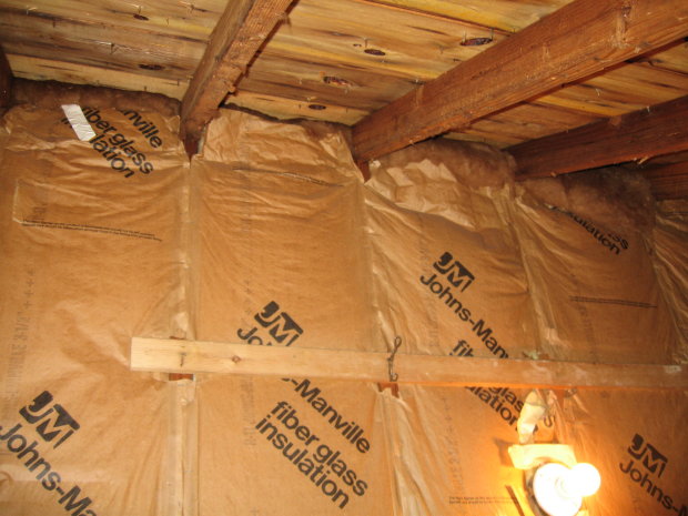

    Here are some pictures of the current situation if anyone else wants to opine. No soffit vents and no baffles. The space from the knee wall and in will be finished eventually. How should it be insulated and ventilated.
    Thanks

    Hmmm... I vote for unvented, insulated with spray foam.

    Without baffles to remove the heat that space, knee wall to soffit will get blistering hot. This will cause the adjacent room to uncomfortable and cut your roof's life short. I'd put in the baffles to vent the space. Soffit vents and a ridge vent.
    Tom
