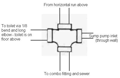

    Last night I was having trouble figuring out how I will fit in all the fittings necessary for the CI removal project I have. Part of the problem is near the same point in the run I need to get a toilet and sump pump drain fitting in. Today the brainstorm arrived and its in the form of either a double sanitary tee or wye (vertically oriented).
    I've read that if the fixtures are far enough apart the tee is ok - they would be at least 18 inches from the branches of the fitting - can I go w/either one depending on how it fits in? I don't have a ton of room to work with.

    WE would have to see the location or a drawing of what you want to do. A third option might be a 3" sanitary tee with a 2", left or right, side inlet for the pump discharge. That would eliminate the two connections opposing each other with the attendant problems that causes.

    Going to 3" isn't an option - there are two sinks on the floor above that drain into the 4" stack which drains into the run I'm working on.
    I'll have to try to take a picture of it - the problem is the combo fitting that I'll be using to replace the 4" CI sanitary tee. That combo is huge compared to the tee and pushes everything back and up compared to the old stuff.
    Ideally it would be a lot easier with a wye and 1/8 and then a 4" 90 degree elbow with a 2" side inlet - but I have never seen one.
    This is a rough idea of what I am thinking about - mainly because the ST fitting has a shorter footprint than a double wye.

    You cannot legally use that fitting, and if there is plumbing on the floor above it using the pipe as a drain, you cannot legally tie the toilet into it, unless you provide it with its own vent.

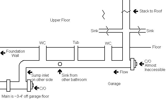

    The solution will be that the toilet will go into a regular wye. The fitting for the pump will be back up the line a bit further.
    If I could find a local plumbing supply house that carries a 4" sanitary tee with a 2" right side inlet it would be a more efficient setup - I will check today w/the place I bought my riser clamps awhile back.
    The unusual setup:
    1. Split foyer house - all fixtures except the washing machine are on the top floor. Two toilets empty into the horizontal, along with the tub and a sink from the small bathroom. It is a form of a wet vent I believe. The laundry room is next to the garage.
    2. The sewer main is in the garage - but not into the floor. It is about 4' off the ground. It runs out behind the house and then down a small incline to the main line. It would take one hell of a backup to get back up that thing.
    3. The laundry room is next to the garage - and has two sump pits in it tied together w/a pipe under the foundation. One looks like it was to empty ground water out into the yard somewhere - but it hasn't been connected in years and was disconnected long before we bought the house. The other is setup for the washing machine to drain into - this is the one that has the sump pump tied into the main line. The only reason I can see for having the pit empty into the line instead of the yard is that every weekend you do laundry you'd have a big wet mess somewhere out there. I would not be surprised at all if this is not allowable, but there is no room upstairs for a laundry room. This house was built in 1971 and there are at least two more on the block designed similar. However, their mains are into the floor.
    So...this is the story. We don't plan on moving any time soon, but the leaky cast iron at ceiling level in the garage has to go one way or another. I'll probably have code violations somewhere in the mix - but I'll do my best so things work.
    Here is an image of the current configuration - this is how it was when we moved in. Its worked fine but the CI is leaking because it has peeled up in one section.

    One last followup - I found a 4" ST w/2" RSI! Woohoo!
