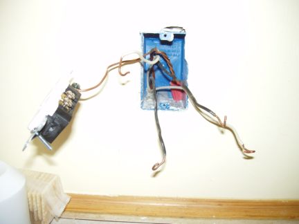

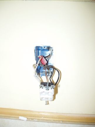

    a while back i replaced my duplex receptacles in the kitchen and in doing so half of them work and half dont. its obvious they were wired in a daisy chain effect but here is my problem.
    the first outlet on the end of the run does not work. the next two in line do (one is a GFI), the next two after that do not work and then the last one is a GFI which does.
    I have two different wiring examples going on. in one junction box there is one cable and 6 wires (2 hot (black) and 2 neutral (white) with two ground). in the next box i have two cables each carrying 3 wires (2 hot (black) and 2 neutral (white) with one ground). i hooked the two hots on the brass terminals and then i hooked the two neutrals to the silver terminals.
    i turned the power back on and my receptacle tester still shows no power at all. the tester i have is a plug in that lights up when all is connected correctly. right now there is nothing.
    is there a specific way in which the hots/neutrals need to be wired? like one needs to be on the top terminal while the other is on the bottom or does it not matter?
    if anyone could help me figure this out i would greatly appreciate it!!!!:
    reds_21
    It doesn't matter which terminal (top or bottom) you attach the wire to.
    My guess is you've got a loose connection somewhere in the circuit. But without being able to visualise the entire circuits, it's gonna be difficult to troubleshoot this way.

    Borrow or buy an inexpensive continuity checker (aka ohmeter). Turn off power at the panel, disconnect everything, and test all the wires to determine a) which pair comes directly from the panel, and b) where they go from there. Draw a picture of what you find. Then it should be easy to see what's going on -- it sounds like you've got the basics right. The 2 GFIs confuse things slightly, but that can be overcome. Normally a GFI would come first in the chain, then the rest would be daisy-chained from it.

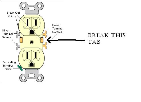

    Kitchen counters may be wired with two separate 20A circuits. You may have only one of them working, and may have inadvertently joined them together. I say this because you indicated one box had two hots coming in. That box may have been a pass-through for the other circuit, and shouldn't be attached to the outlet at all.
    Over here (QC, Canada), most kitchen outlets are wired with 2 circuits on the same outlet so you don't trip the breaker (when plugging the coffee machine and toaster for example). The outlet uses a common neutral and 2 hots. In order to do that, you have to break the tab between the 2 brass-colored terminals. it could be where your problem lies...
