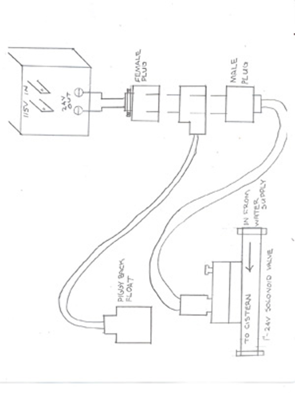

    Me (post originator) again, and my ignorance is still showing. I ordered a liquid level float switch from McMaster-Carr (p/n 51445K91), along with a high amp, 24v control voltage relay. My line of thinking was that I could get a normally closed loop out of the float switch which I could run 24 volts through to operate the relay. Since that no longer appears to be feasible I was pondering plugging a 24v transformer into the piggyback outlet with the output of the transformer going to the relay coil.
    My reason for trying to use low control voltage is the run from the cistern to the Pumptec is a distance of about 100 feet, and I'm trying to avoid the extra work and expense involved in running Romex from one end of the house to the other.
    Are there good reasons not to be powering a transformer up and down in such a fashion? Again, TIA!

    2. The float valve can operate the 24V relay back at where ever the pump and relay is using small gauge wire (even bell wire), not sure what the question is here. The 24 volt relay pulls almost no current.

    The illistration will show how we hook up a float. It's very simple. This is to turn on/off a solonoid valve in an aerator, but the same circuit can be used replacing the solonoid with a contactor.

    Welp, if I were to retract and rephrase my question, it would be: "Is power-cycling a plug-in transformer considered taboo?"
    Speedbump, I had seen your illustration elsewhere but couldn't make it out clearly. I believe you have provided me with my solution. Thanks(!) from a Tampa native.
