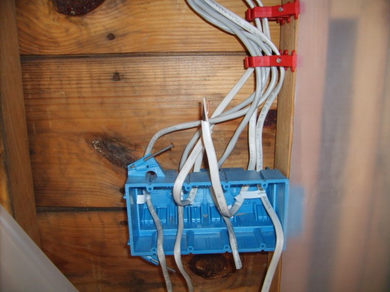

    I need some help with rough in. Attached are 2 pics of what I did.

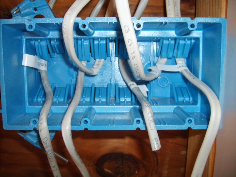

    There are two 14-2 providing power to 4 switches. I labeled each wire it may be hard to see the labels.
    One of the 14-2 will provide power to 600watt track light switch and an outside 100watt light switch.
    The other 14-2 will provide power to two switches each controlling a 50” ceiling fans.
    The inspector came today and left in 10 secs. He said it is not ready, because the splices are not done.
    I thought “rough in” is just having the correct wire, making sure the wire is stapled to the posts correctly? When I asked him what it means to have the “all the splices done” he said go call an electrician.
    Only thing I can think of that he wants me to remove the rubber sheathing from the NM wires, and splice and wire nut all the grounds and natural together. But since I can’t install any of the switches yet. Do I just leave the black wire alone?
    Any help and suggestion is much appreciated.

    Is there a particular reason you can't install the switches yet? Also if you won't be using the angle nails go ahead and pull them from the box.

    How is that box attached?

    I agree with frenchie.
    If that box has screws going through it in the back, it will not pass anyway.
    What the inspector wants is all the grounds made up, all neturals made up, all the hots, with pigtails made up, and the swithlegs waiting for the switches.

    I would screw a piece of 2x4 to that stud behind the boards and drive the nails into it to hold the end of the box in position.
    I can't see the numbers but your box should have the volume marked somewhere. You need enough volume for equivalent of 21 wires, 42 cubic inches.

    Quote Originally Posted by hids2000
    The most important thing here is the equipment grounding conductors and grounded (neutral) conductor.
    All the grounds will be together but the grounded (neutral) conductors must stay with the circuit conductors do not join all them together.
    Once the devices are installed and a cover plate attached these items are no longer visible and would require a good amount of time to inspect on a finial inspection.

    This is a violation of 110.3(B) as well as 314.23(B)(2) and should be rejected. The wall and back of the box are not strong enough to support the box itself.
    the box i am using is a Carlon Wall Boxes, Nonmetallic Four-Gang
    Model BH464A it holds 64cu" so i got enough space.
    One the right side the box has a flange that goes over the 2x4 post which i nailed with two 3" 10D nails. I didn't nail or screw anything to the back of the box. there is in fact about 1" space between the back of the box and the wall.
    I will build out the left side of the box with 2x4 so i can use those 2 build-in nails and make the box more secure.
    I will take a pic later once do up some of the wires so you guys can tell me if it looks good. I am going to make sure all the ground wires are connected and there are 4 pig tails 6" long each for each of the switches. The Neutrals I will wire nut them together and I will leave the hots alone. Does that sound right?
    thanks guys for the info.
    If you indeed have two circuits
    then all the Neutrals would not go together.
    The neutrals of this circuit
    will go together and the neutrals of this circuit
    will go together.
