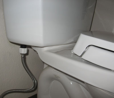

    I now have the new WaterSense HET Eco Drake by TOTO in the Seattle area
    They use 1.28 GPF to flush.
    E-Max Flushing System (1.28GPF / 4.8 LPF)</U>
    They come in Cotton White in
    Regular
    Elongated
    ADA height elongated
    EcoDrake
    Eco Drake in the Seattle and Los Angeles area

    There is no reason to change tank design.
    One thing that determines how well the water drops, is the height.
    They did change the flush valve flapper to release less water.
    They also have a new part number on the bowl.
    I will be interested to see why they changed the bowl numbering and how it's changed.

    Have you figured out what's different about the bowl?
    Apr 2007
    Ontario, Canada
    876
    I can't see any physical difference from the normal bowl.
    They are tested for more than 350 instead of the normal 250 map test.
    I can see a new fill valve and the flapper has a extra float i'm sure to close the flapper even faster than the normal G-max flapper.
