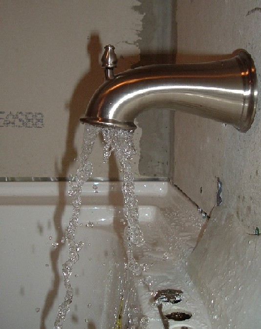

Does anyone know what would cause the water to come out of a tub spout like this (see attached photo)? Instead of coming out in one stream, it is coming out in all directions, like a kitchen sink faucet without an aerator. Some of the water is even going back towards the direction of the overflow drain. This plumbing is for a new tub (not a replacement) in a second floor bathroom, and the spout, valve kit, etc is Price Pfister.

I think I see what appears to be a ledge with predrilled holes below the spout, this tub may have been made for a "roman" type tub faucet, plus the spout is unusually high, usually you need a minimum 1" gap to the flood rim of the tub.
Regular tub spouts aren't made long enough to get past that rim...usually a straight shot to the basin.

Thanks, GrumpyPlumber and jadnashua. The three holes that you see in the photo are actually for the overflow (the cover is missing). This tub has a "deep soak" feature, or in other words, a high overflow. Thanks for the other tips as well - vapor barrier, etc.
Is it possible that there isn't enough water pressure? If so, what can I do to improve this?

Nice photo, but still can't tell. Are you getting good volume out of the spout, or is it weak? The make some long roman tub spouts, which sometimes have an aerator, like a kitchen faucet or lav, to smooth out the flow.

It is the nature of the beast. You have a limited flow coming out of a large opening, so the water does not have enough residual pressure to create a concentrated flow. The diverter may also be affecting it. A different spout may be the only remedy.

I think what's going on is that it's the type of spout that you pull the stem up to get shower water and push it down to get tub water......those things get bad and sometimes are just bad from the factory.
I THINK maybe the thing inside the spout that moves UP to block the flow thus the water goes UP the riser and out the shower head......anyway, that THING....yes thats a technical term.....is either STUCK or is off it's little track it rides up and down on to do it's job, inside the spout......also there's an O ring behind the little "gate" thing and that O ring might be off allowing the water to spray in between the little gate thing and the end of the spout inside.....take it back and tell em it's a defect if you bought it.

I'll defer the question about the spout to the pro plumbers but could a piece of construction trash found its way into the spout?

about the spout and its water: how much flow have you got? Is there a copper pipe inside the spout? If long enough, it should create a nice looking current.
