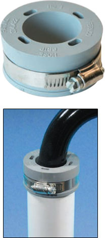

Amana Stainless here too!
I used a 4 inch paint roller and put it into the standpipe and put the hose through it creating a nice tight fit. No more soap suds coming up at the end of the spin cycle. I've heard that you can get a compression fitting that does the same thing. I kind of like the paint roller look!!!

Three theories of suds in the drain -
Maybe this will help?
(ATTACH - 11685)
I think this problem persists, for many people.
My mom's machine is doing it right now.
The plumber couldn't fix it, but he put on the gray rubber collar,
which reduced the outflow by 80-90%, but it still needs to be wrapped with a towel.
I like KULTULZ's example, the almost-sealed fitting and the smooth black hose.
I bet Luann's paint roller works pretty well too.
But I just want people (including washer mfrs) to start thinking about how to prevent suds generation in the drain
instead of trying to seal it in, which isn't quite working in my case.
The machine usually doesn't make suds inside; it's carefully designed not to.
"Inside" would mean before the drain pump, assuming there is one.
The pump might well make suds in the drain hose when it over-runs and sucks air
and pushes bubbles thru the soapy water still standing in the ascending part of the drain hose.
I guess then a smaller diameter of drain-hose might help. (theory1)
The black one shown in the KULTULZ photo is definitely smaller than the big white corrugated hose I've got now.
I'm wondering whether my corrugations make suds when the discharge is running fast. (theory2)
KULTULZ's black hose would be smooth inside.
I'm wondering if the exact angle of the hose end in the mouth of the drain standpipe matters - a flying
arc of water splashing into soapy water below might entrain lots of air, making excess suds. (theory3)
In K's photo the tip of that black hose, inside the standpipe, might be angled against the left wall by the springiness of its 180-degree bend.
I think that might help; the water stream would be hugging the pipe wall instead of plunging headlong into the soapy water below.
All these things can change without being noticed any time the machine is moved or serviced.
The fixes which would help most are different depending on which of these 3 theories is right.
