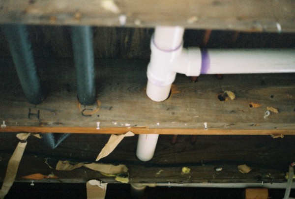

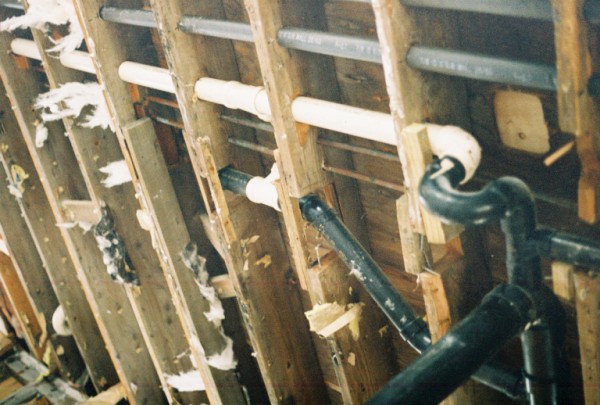

Motoslider - Just try not to wind up with anything like the first pic... (plumbers with a sawzall, I tell you, there ought to be a law...)
oops, that's sideways.
the 2nd pic is what you want.

Like the original pic of the notch for the closet elbow?
Look at the joist on the right: The notch there is REALLY bad as well. And that was one of the 2 with the long span.
