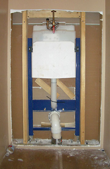

    How does one get technical assistance from this company? I know they're now part of Chicago Faucets, but our plumber can't seem to connect with the right department on problems we're having with a new install.
    The toilet worked when originally installed, but the height was uncomfortably high so we had the toilet lowered and now it doesn't work at all. There's no blockage, the plumber used a camera today to check the waste pipes. With 5 gallon bucket of water poured into the bowl, water will go over the trap, but the toilet does not flush properly.

    A toilet is not rocket science, unless it is in the space shuttle. If it did work, and doesn't now after lowering it, then you have to tell us, or show us, how it was lowered. And what is different between then and now.
    After reading David's response, I contacted technical assistance via email and have been corresponding with them. When the toilet was lowered, the original waste elbow was replaced with pvc piping to accomodate the new height (I did post a picture, but don't have a before shot). This is the apparent cause of the no flush situation. The tech says the toilet will only work with the original "syphonic" discharge tube and that tube cannot be cut or altered and must go straight down (even though the tube has this little bend in it). If that's true, then we're stuck with a toilet at a height that's uncomfortable for me, an average height woman (the height of the rim will be 18.5 inches and with the seat will be about 19.5 inches) and we'll have to deconstruct the wall that was just redone to move the toilet down. I'll post a follow up to let you know how it gets resolved if anyone is interested.

    at floor level, the Tessera's special patented twist in its pipe goes straight, and that is where one should cut, in order to shorten the height. AFAIK, but I have never done it, only seen it in the PDF's. Most installations are not too high, so i am 100% positively sure that it can be done, you can have a Tessera installed at the height you want.
    An alternative to consider now is to reinstall it high with a platform under the toilet floor, like duckboard.
