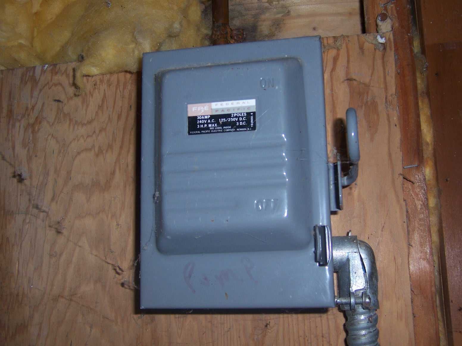

    Default is this the dconnect?
    is this it? this is for my well pump
    TIA,
    molo
    "Any American who is prepared to run for President should automatically, by definition, be disqualified from ever doing so."
    Gore Vidal.

    Yes........... .
    23,562
    Default disconnect
    Only you can tell, because only you can see where the wires are connected.

    Quote Originally Posted by molo
    Is what it? What is the question?

    THIS DCONNECT IS FOR MY WELL PUMP, i"m wONDERING IF THIS IS THE KIND i nEED FOR MY WATER TANK
    tia,
    MOLO
    Yes?
    I don't think you'll find one like that but that one will work. A simple little 60A "pull-out" disconnect would be the easiest.
