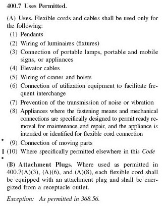

I don't think you understand what "unless specifically permitted" means. In code speak, the key word here is "specifically". There would have to be something in 400.7 that said some kinds of wires could be run through dryer vents, and there isn't.
The interpretation you're using of 400.7, would make 400.8 completely redundant. If I can run an extension cord through a wall for any purpose that I'm allowed to use an extension cord in the first place, there would be no possible situation where I couldn't run a cord through a wall, except situation where I can't use a cord in the first place. Think about it. 400.8 would become meaningless.
I did ask nicely at first but never got a decent response.
Regarding "unless specifically permitted" the code actually doesn't say ANYTHING about any specific
kinds of openings in the wall in which you COULD run a flexible cable through. According to you and him that means you can never do it.
Yet the code pretty blatantly says that under certain circumstances such as with "utilization equipment to facilitate frequent interchange" which includes RVs you
can do it. 400.8 says that it's allowed depending on certain conditions outlined in 400.7. Pretty sure that, under any sort of logic, means that for RVs you can run a flexible cable through a wall of an RV or other "utilization equipment to facilitate frequent interchange". Plus the fact that they do it on new RVs made in the USA. They use a special hatch/storage place for the hookup on the RV, but..... the code never says that it has to be a special kind of opening. The special openings on RVs are there just because thats the optimal way to do it. In the case of what I'm doing, a dryer vent is the optimal way to do it. Both are plastic, weather proof openings that allow the flexible cable to enter the RV.
Unless the code contradicts itself that means you can run a flexible cable through the wall of an RV with any safe means needed. Weather proofing the hole in which it runs through is just plain common sense. If they added in every possible thing you must do for wiring, the NEC code would be a do-it-yourself guide to electrical wiring. They assume you know how properly and safely run the cable/wire you are installing so that you don't have water coming in the hole in which the cable is running.
Also, I found a site that lists all of the 2005 NEC codes. There is a section (B) of 400.7 not posted up to now in this thread that points out about section 6 of 400.7(A) that states attachment plugs placed on flexible cable is permitted for plugging into an outlet for power. That would mean you can have a flexible cable to plug into an outlet for power according to 400.7(A). 400.8 seems to state that if 400.7(A) 6 is met then running the cable through a wall is permitted according to 400.8.
Again, no where in 400.7 or 400.8 does it say any certain openings in the wall are allowed. 400.8 states that unless specifically permitted in section 400.7 it is not permitted to run a flexible cable through a wall. However, an RV falls under 400.7 sec 6 and therefore is permitted to have a flexible cable with a plug on it run through the wall. But it does not state that it needs any certain kind of opening in the wall anywhere in the code.
Check out the attached image for the 400.7(B) section. I got that from here:
http://www.nfpa.org/freecodes/free_access_agreement.asp?id=
The format in which the site presents the NEC codes via Java doesn't allow copy and paste so that is why I did a screen shot image instead.
