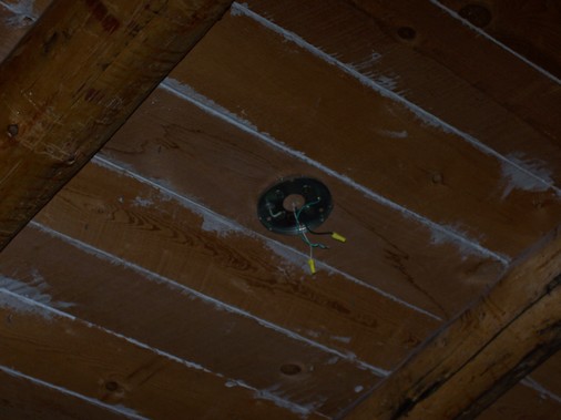

    The old ceiling fan was mounted directly to the wood ceiling with no box. (see pic).
    Do they make a small, shallow, surface-mounted box that will screw into the wood?
    The box needs to be small and shallow so the metal "cap" will cover the box, ball and socket, and all the wires.

    You can get a pancake box that will be covered by the enclosure of the fan. The box can mount to the ceiling without cutting into the wood.

    Look for one rated for a fan. The screw holes in a 'normal' one probably would hold, but the fan rated ones will be beefed up. the stock ones are designed to hold all of a cover, not the 40-50 pounds a fan can weigh not counting the torque when starting up.

    I would fix something to attach the fan securely to the ceiling, such as screws through or outside the box into the ceiling itself, or by bolting the fan attachment to the box.
