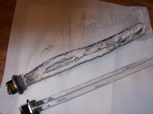

    Default "A Pretty One" To quote MP Mark
    I haven't changed out too many of these, but this element has to be about as bad as they get.
    This tank has a lime build-up that is almost as high as the lower element, so unless we address this problem, the new element will not last very long. Is there anything I can use to dissolve the lime deposits so it can be flushed out?

    Quote Originally Posted by Verdeboy
    Cleaning the lime out of the tank is a pain in the a**!!! Been through that...a couple of months ago actually! Removed the tank from my house, laid it on its side in my yard, and poured 5 gallons of white vinegar in it, and rolled the tank around in the yard every half hour or so...ALL DAY LONG! I have extremely hard well water here, and no softener, but Im learning! You can buy an element called a "limeguard". I dont remember who makes them, but I have them. When I cleaned my tank, which for some dumb reason, I havent flushed in almost a year, I removed the elements, and they still looked to be in great condition. From the way it was explained to me, the lime guard elements are made out of something that has a high expansion and contraction rate, and as the element heats up and cools, the expansion and contraction cracks the lime off. Looks to be some sort of a silver or aluminum plating over a copper element. I do know this; I was replacing elements every 6 months (top and bottom), and the ones I have now are either two or three years old. Cant remember exactly, but they are still there. I was advised to turn off the power, hook up a hose to the drain, open the drain, and when the water coming from the hose gets cold, allow it to run for another 10-15 minutes, and to do this every third month. For some dumb reason, Ive neglected this for almost a year now! Never again!
