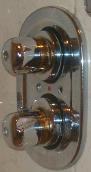

I am having great difficulty identifying the brand and model of shower fixtures in the attached photo. The mixing valve is non-functional and I need to replace it. Of the 2 handles showing, the top one controls the flow to the hand shower and the bottom one (which I taped in place for the photo) is for the mixing valve. There is a third handle that controls the flow to the wall mounted nozzles, but I had to crop the image to get the file size small enough to attach it. I can provide other images of the actual valve if needed.
I was originally told by a local supplier that the part I need is a Kohler part # 78913. Kohler sent me that part but it was too large. They look almost identical. Kohler has since told me that what I have is not a Kohler product. There is no brand indicated on any of the parts other than a logo on the plastic handle, but I can't find any reference to that logo on the web.
Any help you can provide in identifying my shower will be greatly appreciated. Thanks.

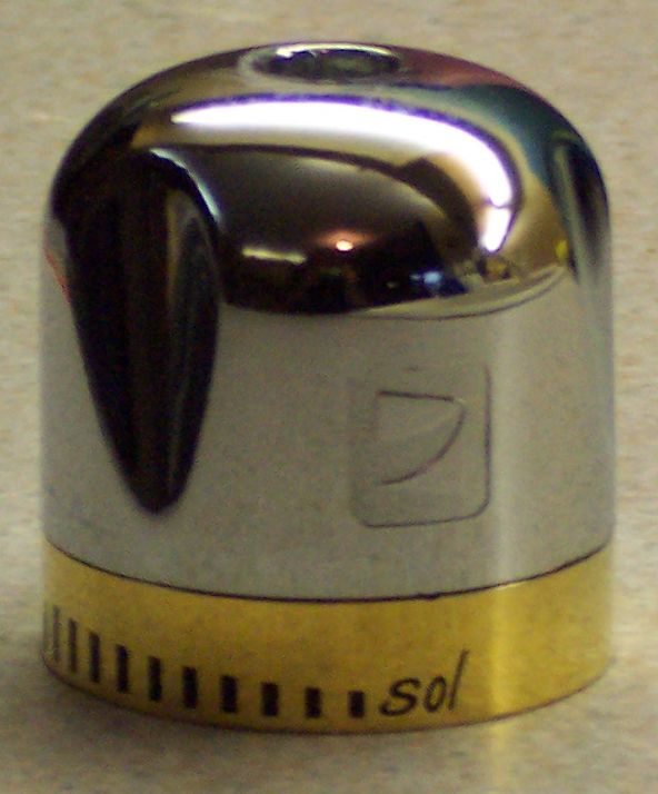

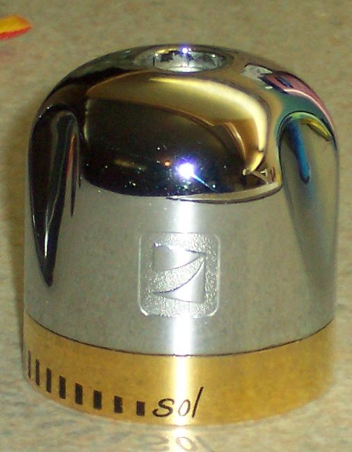

Here's the logo
Here are a couple of photos of the handle with the logo on it.
I took a closer look at the rough-in behind the tiles and I saw the letters SOL in the casting. (Where have I seen that before? Duh, on the handles.) I have tried searching the web for SOL, but the only plumbing connection I see is a line of bathtubs. No fixtures.
