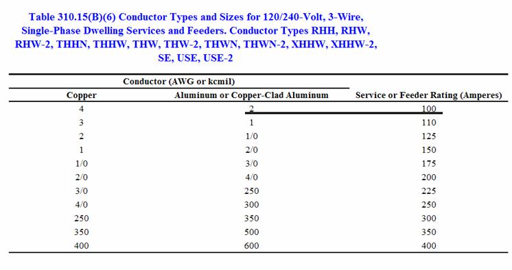

    Anyone has a link for a chart for how many amps each AWG can handle in both Aluminum and copper? i am looking for something that can handle 60amp, 100amp, and 200amp

    well i hired a contractor to run a 200amp and a 100amp into my 2 family house.
    and from what i can tell he is running a #4AWG alum wire for the 100amp main panel from the meter. I thought that wire is only rated for 60amp? The run is only like 4 feet from the meters to the 2 main panels. I just want to make sure he is running the correct wire and i wont have a problem when i start to pull 80 - 90 amps out of that panel because HVAC systems are going in next week. I live in NJ just out side of Manhattan.

    This is what I can read from the side of the cable.
    (UL) 2 CDR AWG 2-1 CDR AWG 4 COMPACT ALUMAFLEX TYPE XHHW-2 CDRS 600 VOLTS (TM) AA8176

    Listen I am not trying to razz you or anything like that but you hired an electrician and then you start questioning his ability and knowledge.
    Not only is the electrician making the installation but an inspector is going to look at his work to see if it is done correctly.
    Now you and start questioning the ability of the electrician and his methods of installation without even giving the inspector a chance to look at the compliance of his work
    You seem to think that the Service Cable is two small for what ever reason and it is obvious that you don’t understand what size cable is installed.
    Look at the Table I posted and you can see that a #2 aluminum conductor is rated at 100 amps for a Service Cable.
    The numbers on the cable that you posted are as follows:
    Quote Originally Posted by hids2000
    This is (“2 CDR AWG 2”) Two cords of #2 American Wire Gauge and (“1 CDR AWG 4”) One cord #4 American Wire Gauge and these cords are compact alumaflex type xhhw-2 rated at 600 volts. This is the correct size cable. If you are addressing the #4 cord in this cable you have to go to 220.61 to learn how to size the smaller grounded (neutral) conductor.

    Leave the electrician alone and let the inspector be the one to point out any violations as this cable is the correct size for a 100 amp panel.
