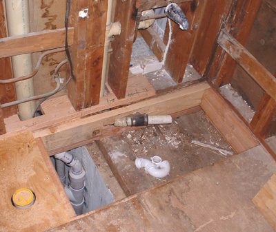

    Replaced part of 2x6 sole plate beneath wet wall between bathrooms. Note new 2x10 joist has been added beneath 2x6, and new 2x6 nailer has been notched & sistered to joist. Added 2x6 bracing/nailers (1 at exterior wall; 1 to right if toilet). Replaced some bad 5/8 ply.

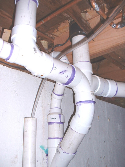

    From beneath you can see new joist, sister & blocking. To left of stack, in other bathroom, you can see a temporary joist has been added (right above the shims, just to the right of the red shutoff valves). Joist is temporary as we could only place it as far as to sit on the sill. Could not (yet) tie it in to the doubled 2x6 bracing like the other joist. There just isn't enough maneuvering room until the left bathroom's subfloor gets taken up.

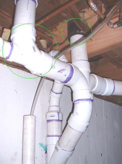

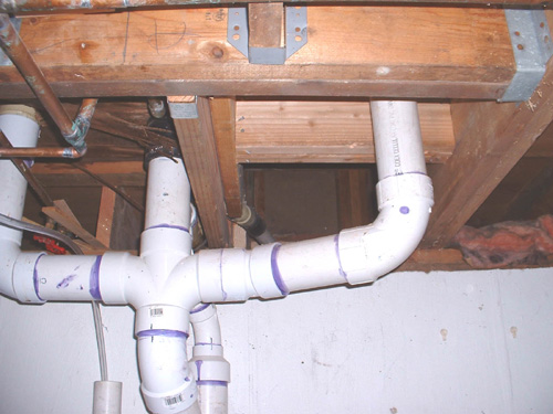

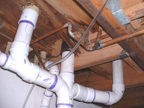

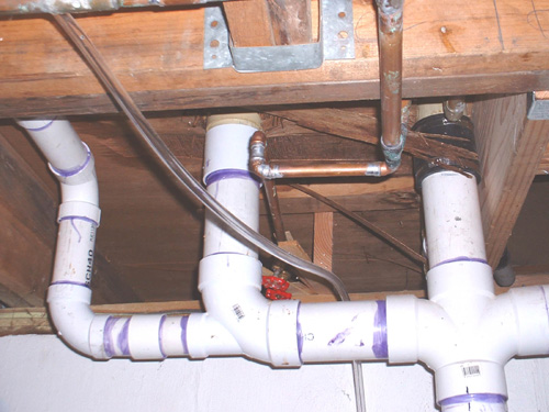

    So much for the framing...the following 3 show the plumbing changes. Nothing drastic, just needed the monster lower. Hopefully doesn't give you guys too many concerns
    Note in this first one the little drop the plumber made in the copper that goes out to the hose bib. If he would have lowered that MORE we could likely have extended that left bathroom's new joist beyond the sill and tied into the doubled blocking.
    As for the rest of the plumbing, I didn't repost the BEFORE pix, but they're located at the original "redo stack" post http://www.terrylove.com/forums/showthread.php?t=13708

    Just took a quick peek...
    I would not be able to use the low-heel 90 where it is - I would have to use a 3" combo with a 3X2 reducer in the end of it...
    The low heel 90 like that is like using a santee on it's back...
    Replace the fernco rubber coupling with a shielded coupling (with a fuill metal shield around it). The rubber ones are only allowed underground.
