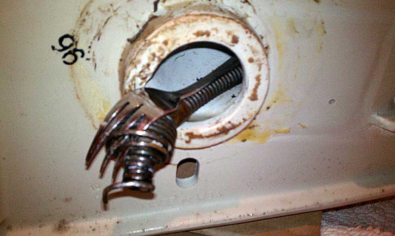

    14,201
    Here is a fork that was removed from a toilet bowl. The closet auger snatched the fork, but when I tried to pull it back, it spread out and would stick. I had to push it all the way through and then remove the fork from the snake. The homeowner decided against reusing the fork.
    Things that young kids put in toilets.
