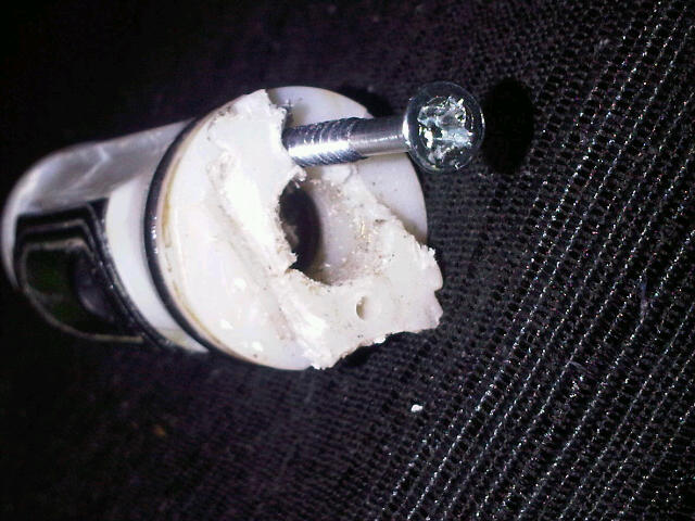

my shower/tub handle broke while turning it. when I unscrewed everything, I see the cartridge white plastic eaten up and the post I believe its called ( the round metal brass bolt in the center ) of the stem broken in the handle.
so a removal tool was useless, i got a free replacement cartridge Moen 1222 from HomeDepot, no way to tell my model, except i checked all shower/tub handles on Moen website and it seems they all use 1222. the 1222 still doesnt look like my cartridge, mine has very white plastic, the house was built around 2000.
anyway i drilled 2 1/8" hole in the plastic and put in the holes self drilling screws, tried to twist the screws with a nut wrench and the screws bent and the cartridge didn't move at all, and the plastic broke, i can now see the metal and one round rubber came out.
I tried using a 1/4" self drilling screw in one of the holes but it was too close to the pipe so I stopped.
I have used vinegar. nothing.
now that the plastic broke a bit I can see the post (the round metal brass bolt in the center) which is about 1cm long, I tried to pull it with pliers, and couldn't cause I cant reach deep enough to have a good grasp.

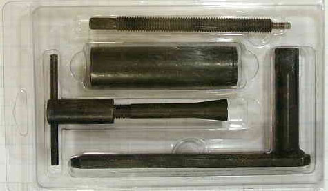

I'm gona buy the Lasco 13-2125 removal tool if i ever get the stem out.
