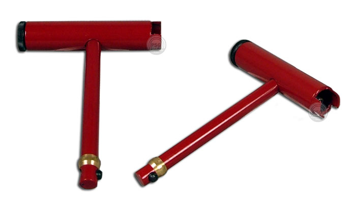

    The reason moen suggested vinigar is it is safe for your drinking water. Remember you are dealing with your drinking water and chemicals can poison you.
    To remove the cartridge you first have to turn the water off to the house. Remove the clip. The cartridge is very hard to remove with out a removal tool. The tool link I have attached below. The tool has groves on the tee handle fit on the cartridge and there is a screw that will screw into the cartridge were the handle goes. This tool will allow you to rotate the cartridge while pulling it out. Spin and pull the require some effort and this tool gives you a handle to rotate and pull.
    If the center section comes out, and the outer ring of the cartridge remains this tools other end has a pin that is covered up by a compression ring. Cover the pin with the compression ring on the tool and stick that end of the tool in the cartridge center. the tool will slide all the way down approx. 2 to 3 inches rotate and the pin will lock onto the cartridge. rotate several times while pulling up.
    Remember you are as good as your tools. I have removed hundreds with little effort. You are only as good as your tools.
    moen tool----
