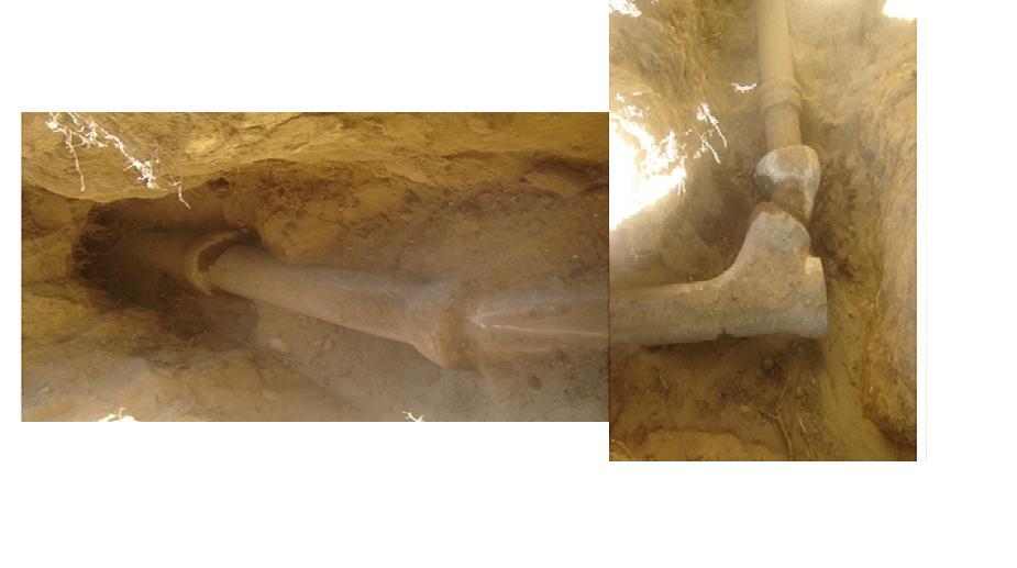

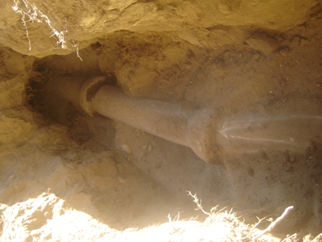

    So after 3 more hours of digging last night, I found the root of the problem...yes, roots!!!
    Also, I found that the beginning of the pipe that comes out from the foundation is 4 inch cast iron, it is then connected to a thicker concrete-like pipe.
    The first piece makes a 90 degree turn and then each piece is about 3 feet long, the outside diameter is about 5.5 inches and each connection has some roots going into it.
    My plan is to install the clean-out next to the cast iron, and then replace the next 3-4 sections of concrete with 4 inch PVC based on your advice using the no-hub clamps.
    My problem now is, how do I connect between PVC and the concrete pipe?
    I attached a couple of pictures of the CI to Concrete and the 90 degree bend and also the Concrete to Concrete part.
