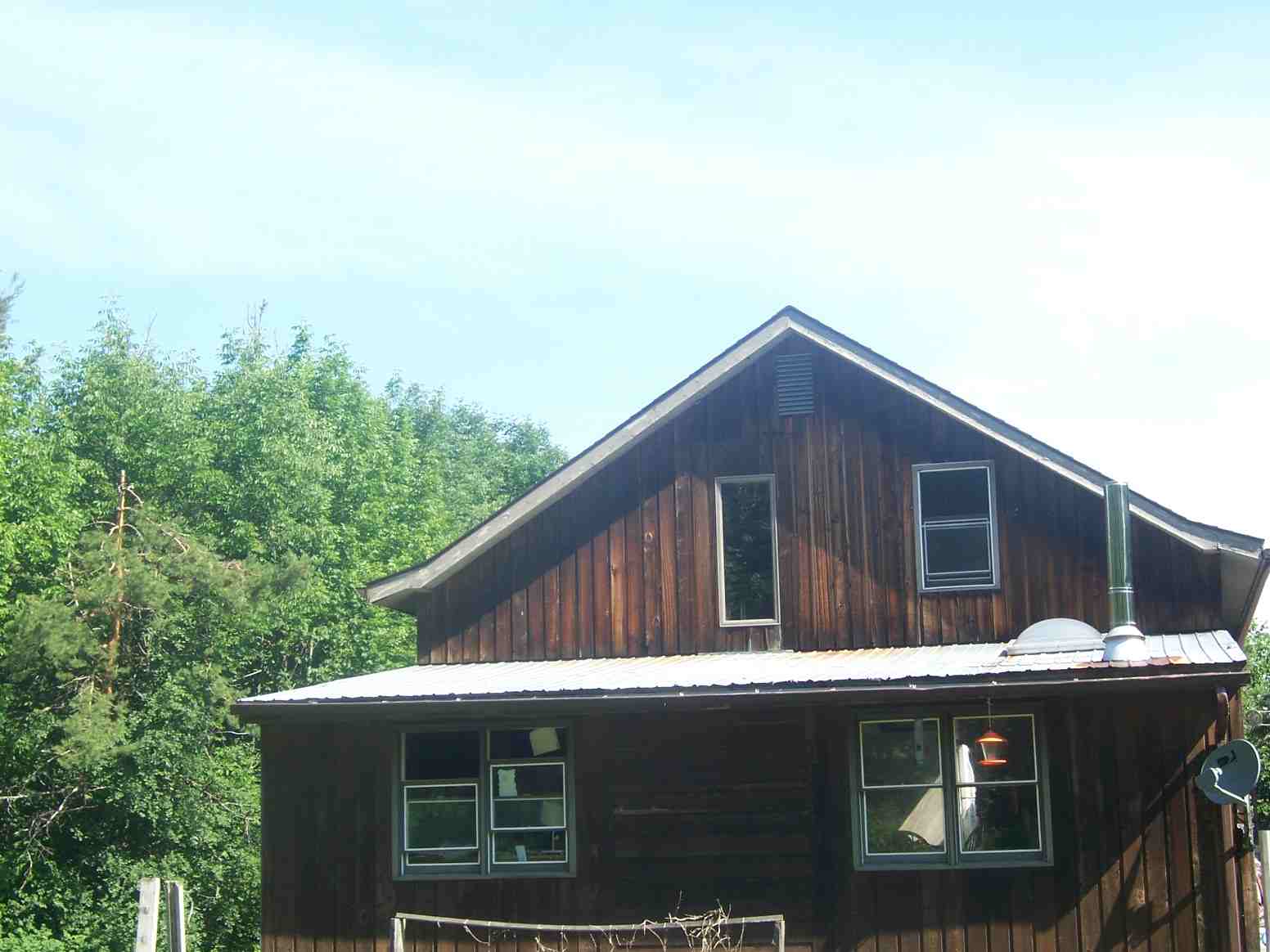

I'm in a cold climate (new york state), but we get 3 months of warm weather, and them some occasional warm weather for may and september. Look at this roof, it faces south and gets HOT!. I would like to set something up, anything, to collect this heat. I don't want to spend much, and can build, or have built, components if I need to.
Any Ideas?

As far as a cold climate goes, I can't help you much....... but I do know that frozen water is the last thing in the world that you want in a solar collector. As the water expands into ice, it will tear it to shreds. But they do have a relief valve that prevents it from freezing by blowing out water, thereby keeping it moving (and warm). I remember the first time mine did that, I was freaking cuz I had water pouring off my roof... :D

Your cost to pay back is not worth it for you. Save your money.

They are solar hot water heating systems. And I think collector of evacuated tubes with heat pipe in is better than flat plate collectors, for they are no water in the collector no fear of freeze. and evacuated tube collectors is of high efficiency.
For cold areas, you will need heat exchanger(usually copper coils in the tank) for heating exchanger. Before using, you should filling anti freeize into the pipeline. And that is called indirect circulation system.

Lots of ideas
You don't need 'warm weather' to make hot water - You just need lots of sunshine. My system makes lots of really HOT water even on 40 degree days . . . . so long as the sun is shining, and where I live, it usually is
If the system components were all 'home made' it would probably make 75% less than it does, because nothing beats a high tech collector and a well insulated storage tank - I spent about $2500 on components . . . . and the government immediately paid me back about 1/3rd of that on my first year's income taxes. My system has been up and running now for 4 years and since it provides more than 90% of my family's hot water needs year 'round, I'm getting really near the 'paid for' point so it will all be gravy now for the next several years
I spent right at $1K for my single 4 by 10 foot AET panel, another $600 for my two Sears PowerMiser 12 water heaters/storage tanks and then another several hundred for differential controllers, pumps, valves, copper tubing and insulation - I installed everything myself
We'd all like 'something for nothing' I guess, but there are areas where you really do get what you pay for and solar water heating is one of them. I suppose you could spend a few hundred dollars for something which might meet 10 or 15% of your family's needs . . . . and your home-made system might last you a year or two . . . . maybe more assuming nothing freezes and the wind doesn't blow it away, but I would advise you either plan on spending whatever it takes to do it properly . . . . or treat your efforts as an entertainment/learning experience - Which will likely have you spending the $$$ to do it correctly at some point in the near future
