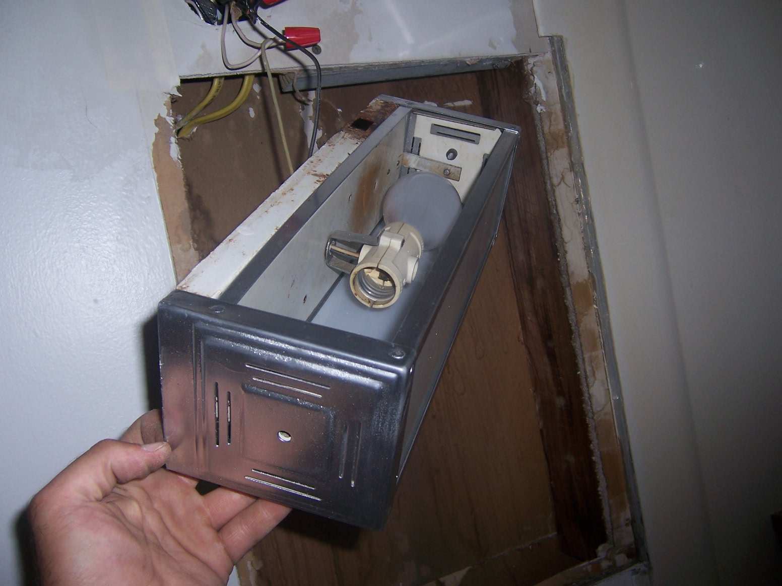

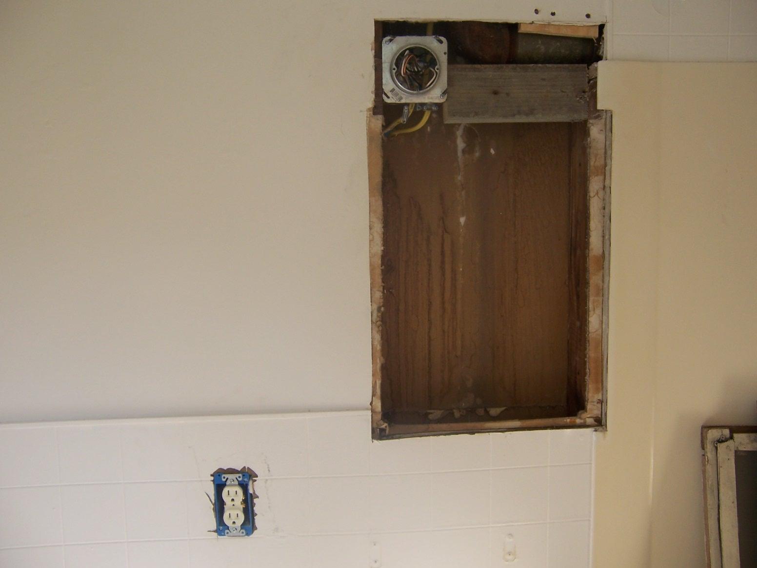

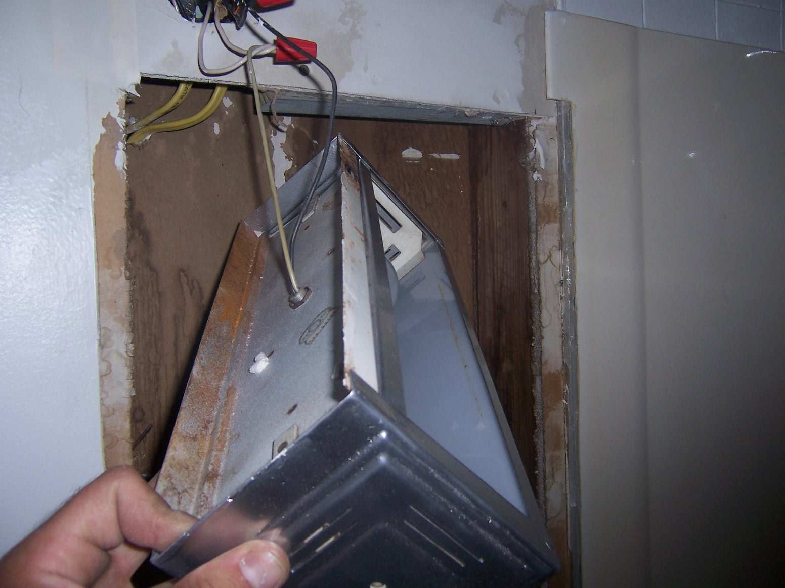

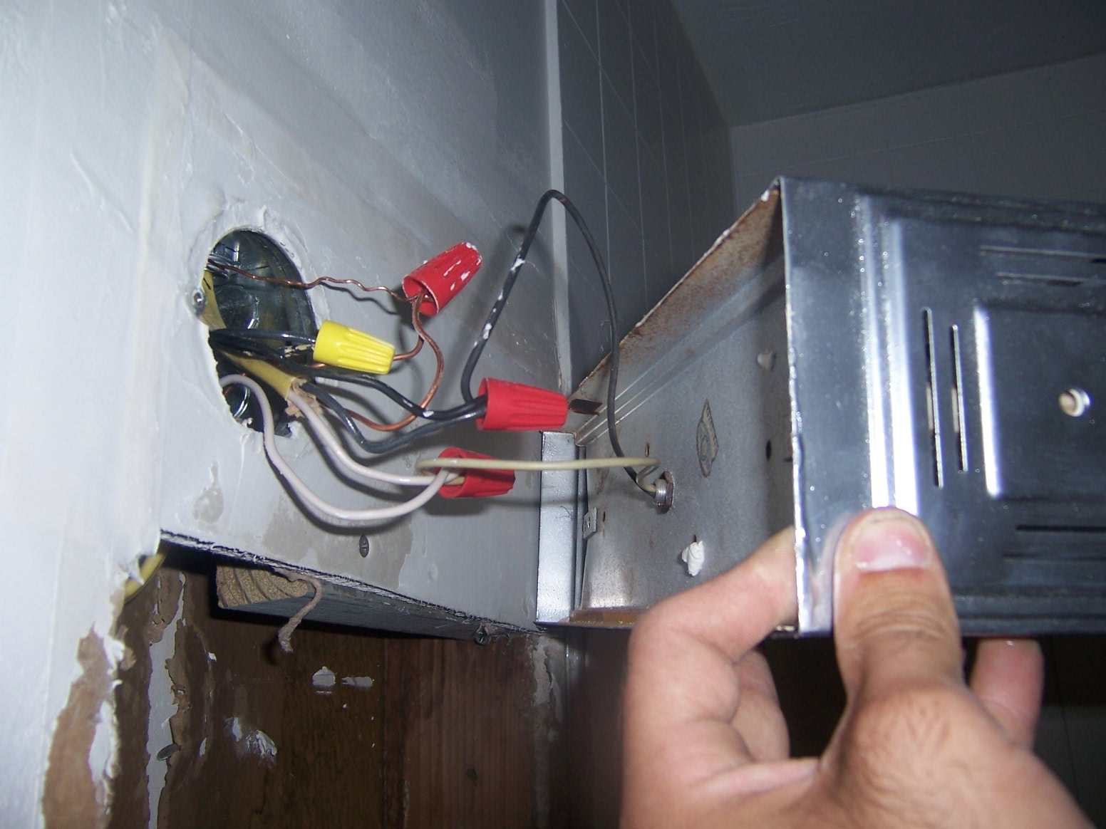

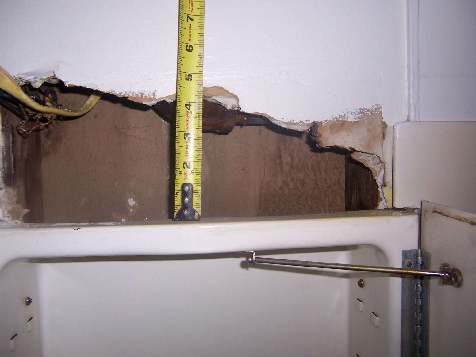

Ok, this is what I've done. I've temporarily installed the outlet and light fixture to see if this worked. I will be replacing the temporary standard 15 amp outlet with a 15 amp GFCI outletas soon as I get to the store, and I will be replacing the light IF you experts STILL think it's unsafe. PLEASE look at the photos of the light fixture with the front attached and tell me if it's still unsafe. This is exactly how it was installed when I got to it.
How I wired this:
I used a large metal box (4" x4" x 2 1/8" deep) above the medicine cabinet. I also installed an outlet box to the right of the vanity (in photo). I used the big metal box to junction the old power leg with new power going to the outlet. Then I brought powre out of the outlet back into the big metal box and used that as my power leg to wire the switch, light, and fan to.
1. Is this light still dangerous?
2. What is the best way to hande the 5 ground wires?
TIA,
Molo

You done a good job. Make sure that all the wires go into the box and nothing is left out except the fixture wires.
Where is the receptacle?

If you look at photo 1 from my last post, the receptacle is at the lower left.

My fault, just didn't look hard enough
Less dangerous now that it was before. It will be fine
TIA,
Molo
Not sure what you are asking but be sure to bond the metal box and use a wire nut on the grounds ( I think this is what you are asking)

Means you connect the metal box to the ground wires.
Look for a grounding screw, inside the box. If there isn't one, look for a grounding-screw-hole. It's often got a little arrow nearby, and the letters "grd.", to differentiate it from the mounting holes.
If you need to get grounding screws, any electrical supply will have them, even HD has them sometimes.
Connect a pigtail under the screw, join the other end with your ground wires bundle. Which you connect all together, as Mike mentioned, with a wire nut.
