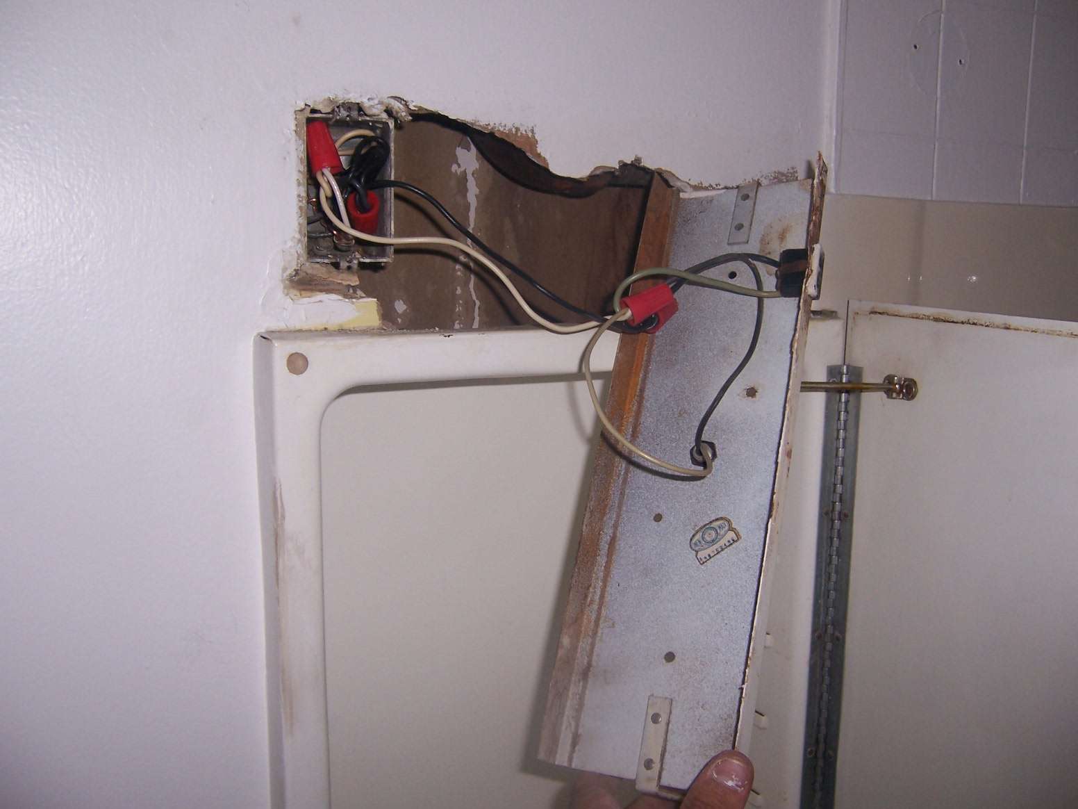

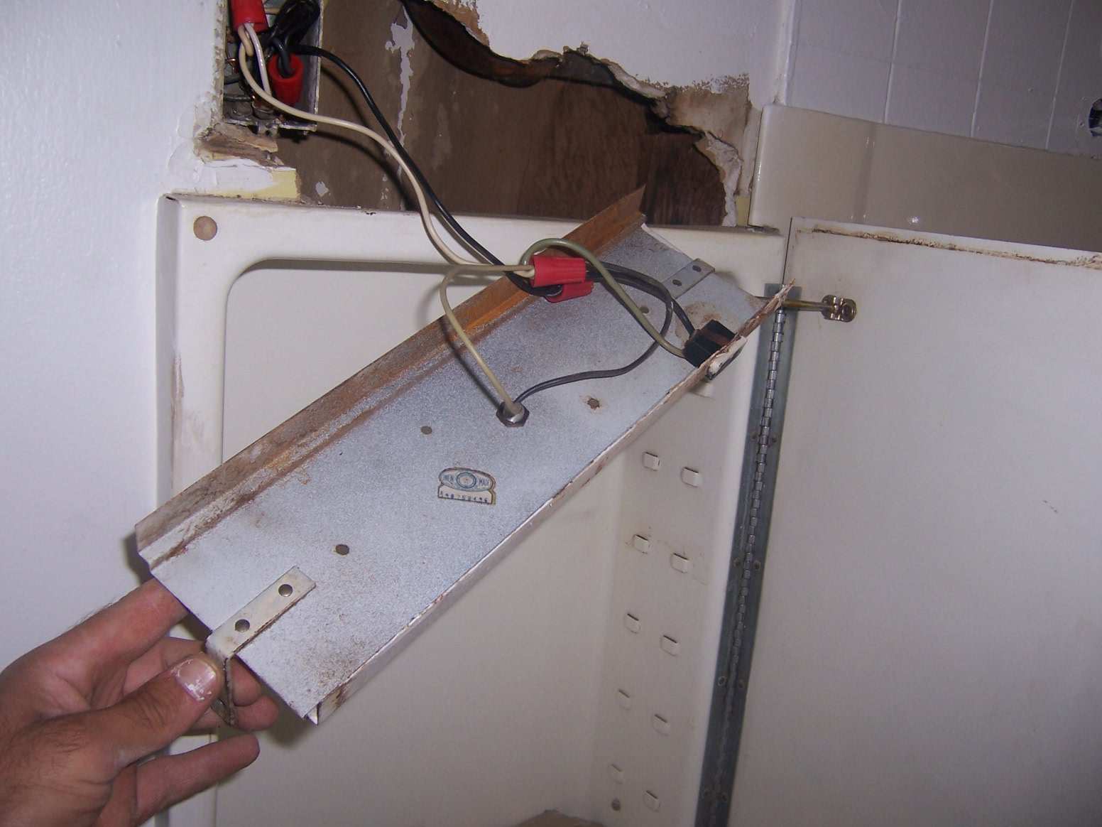

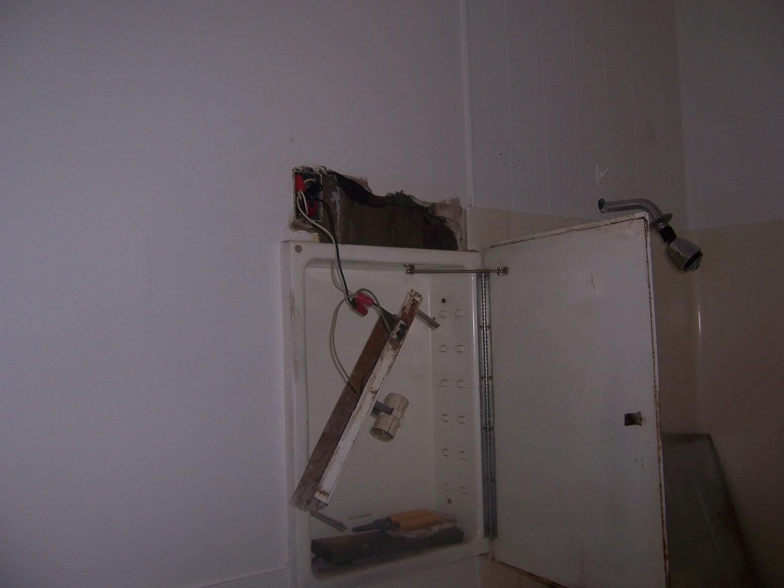

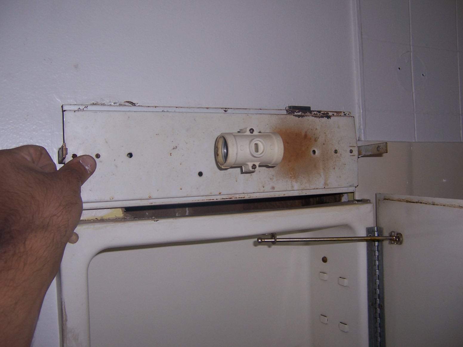

Is this light dangerous? I have provided four photos of the light above my medicine cabinet. Can you experts tell what's wrong with this light if anything? It is old, but if it's safe I will reinstall it.
If it is dangerous, I have the challenge of finding a new light that is approximately 14" long (the width of the medicine cabinet. There is currently no GFCI outlet in this bathroom, do they make new lights with GFCI outlets on them?
I appreciate the input from anyone,
Thanks in advance, Molo

It looks unbroken, are you concerned that one side is a little rusty? If it is not damaged then there is no reason to think anything is wrong. Usually the convience plug is facing down so it can be used, intended for an electric razor. You won't find a GFCI light fixture because only receptacles are GFCI protected.

I believe I see a ground wire in the wall box ...
I would try to fish some wire down the wall alongside the cabinet (maybe about halfway down), then install a GF outlet and power it from the original wire ... then run protected power back up to the light and remove its 2-prong outlet altogether.

In particular, I am wondering if the fact that the back of the light fixture being so open is OK? Essentially the wire nuts that are connecting the box to the light will be hangin in the open wall cavity. So essentially it will be a junction made outside of a metal box. Is this safe?

There should/must be a ground wire to the light's housing and the receptacle has to be removed, or at least disconnected. Normally the light's wiring would be connected directly to the wires in the box, rather than having the pigtails to extend the leads.
I can't tell for sure, but it looks like the neutral is bonded to the case of the light fixture. I'd replace the thing, move the box so that it is centered over the cabinet and the light can be anchored as designed. I'd much prefer a safety ground on the light, especially since it is in a bathroom. If you then fix up the drywall, plaster, whatever there, your choice of fixtures goes up to nearly infinity...there is a huge quantity of lamp available. Before you move the box, check out the light, you may find one deeper than you want, and need to raise it a bit so the light doesn't hang over the top of the cabinet.

The outlet is not safe and the wall being torn up is possibly more unsafe.
If there is an elec problem, it is generally at the wire connections. The boxes are designed to contain these problems for a reasonable time. If you have arcing in this j box, you have an open cell into the attic.
Repair the wall and properly install a new fixture. If the wies and lampholders look good, just disconnect the outlet and use the old fixture.
You could add a GFCI outlet below this fixture but if there is only one set of wires in the fixture the GFCI will only be hot when the light is switched on.

Definitely want all connections to be inside a box. No splices in the wall cavity.

If splices "in the wall cavity" aren't allowed (which I am aware of), then the design of this light, with it's open back allows for splices on the outside of the wall cavity. The back of this light is 14" wide and 4" high of open space where the wires can drift around outside of the box where they are coming from. Are these kinds of splices safe? Also, I agree Frenchie, as long as I have it open right now I might as well incorporate the GFCI, and do whatever I need to do to bring the box size to meet code. Presently the power comes into the box that is directly behind the light, and is run over to the switch. The box behind the light and the switch box are the only two boxes in the bathroom. I would like to add a ceiling fan/light (controlled by the same switch), and a GFCI outlet.

All splices and joints as well as conductors MUST be in the box.

looking at the light it seems that it could be turned with the lampholders covering the box that is already installed.
