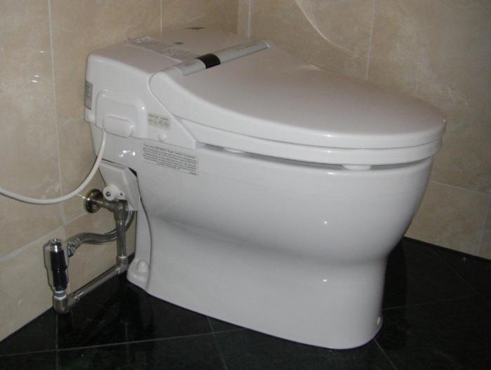

  4. #34
    14,195
    I think you have a little leeway. The 500's that I have installed did not touch the wall.
    Also, the outlet of the adapter is about 2", dropping into a 3" drain.
    You can fudge the adapter forward a little bit if needed. That would be much, much better then installing a needless offset.
    I believe this was about 11.5" from the wall.

  6. #36
    DIY Junior Member Faux Plumber's Avatar
    Nov 2010
    Stamford, CT
    Default Neorest installed!
    Thanks to Terry's encouragement (that an 11.5 inch rough-in would be sufficient) we ordered a Neorest 500 for a bathroom we are re-doing and which I had already closed and tiled with large (13 in. x 26 in.) tiles. We hadn't decided on the Neorest before I closed the wall and tiled it, so we had concerns about the rough-in, which was just a bit shy of 11.5 inches, and the supply line which was six inches from the center of the toilet.
    I measured the horizontal distance between the back of the washlet after it has been installed on the toilet, and the center line of the bolt holes at the bottom, and found that that distance was about 3 1/8inches. I measured and re-measured the distance between the bolt holes in the gray outlet connection when installed over the waste flange, and the back wall. That was 3 1/4 inches. So, I went ahead and drilled the holes for the gray outlet connection in the green marble tile I had laid, and then my wife and I carefully lowered the toilet over the gray outlet connection. We were relieved to find that the fit was perfect, and the clearances looked very much as in the picture in Terry's first post.
    The water supply had to be moved over, and I did that with a few elbows and nipples (which I threaded manually from stainless steel pipe stock, hence my chosen name Faux Plumber.)
    The result is as in the picture.
    Thanks, Terry, for your encouragement and your wonderful Forum.
