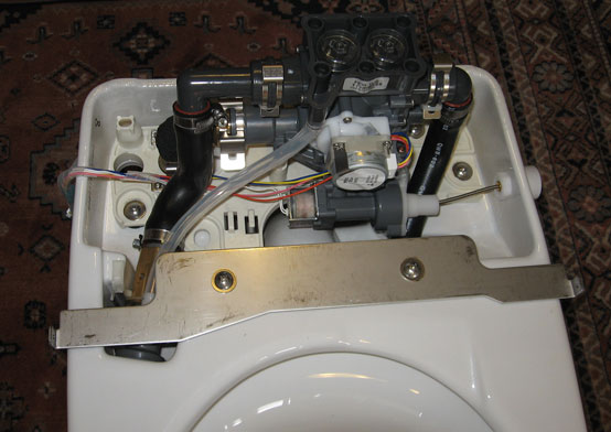

    Some of the controls under the cover.

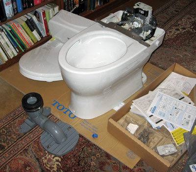

    It takes an adapter that holds two bolts at the back, and a block that receives a screw at the front.

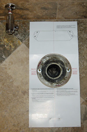

    In the box comes a special shutoff for the braided hose.
    Normally it would be angle more toward the bowl, but the bowl set too close for that.
    The specs call for about 11.5" toward the left.
    A nice big box that holds everything.

    Everything out of the box.
    [/URL][/CENTER]
    You imply above that for the pictured install you went for a less than 11.5" OC from the middle of the toilet flange to the water supply. My question is...in looking at the drawings it appears at the base that the toilet is only 5.5" wide from center to either side. Why are they asking for 11.5" offset? I have about 8" to work with (small bathroom - even with all the drywall pulled back to get at the piping)....based upon your experience is 11" necessary? Would 8" (likely) work? While I'm at it, the schematic is also suggesting 6" from the floor for the water supply...I can see some part of that would be necessary due to the 'nose' of the fitting...but is that much truly necessary?
    Thanks in advance!
    12,447
    The ones I installed had the water closer than the suggested distance.
    Unless someone knows before the drywall is installed that the Neorest is to be installed, it's doubtfull that it will be at 11.5"
    That being the case, you just do the best you can, with what you have.
    8" should work on the supply.
    Sometimes you can move the line outside of the wall too.
