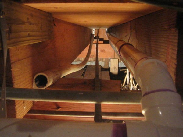

Hya, Kordst! Remember me? I have a picture for you, check it out...
Which one do you think was done by a licensed plumber, and which one do you think was by the caretaker?

frenchie said:
Now, now, boys...
It's a DIY site. Play nice.
It's the new, code approved flexable vent pipe...isn't it?...right?
We're playing nice...for the record maybe someone just saw that about toilets and learned what NOT to do...(I really do hate getting those ones, almost like I'm guilty for getting paid)

Nothing against you, bro. The thread just seemed to be hading in a not-nice direction, I wanted to cut that off...
I do know what you mean, about feeling guilty taking the check; just remember, it's not your fault. It's not even his fault, really - who would've expected that?
Although you have to wonder how he never noticed the toilet was loose... do they never use that bathroom, or what?
...speaking of vent pipes... that run isn't vented, either. We're rebuilding the place next year, so for now I just oversized the pipe.
I wish they would change the code on all kitchen sink drains AND any drain subjected to large volumes of hot waste water be strapped every 2'....not the normal support of 4' for PVC.
I have seen too many kitchen sink drains in 1.5" strapped every 4 feet that just completely sags between the straps....all because the dishwasher dumps into that line a great deal.

frenchie
I don't recall ya. I would guess that a licensed plumber did the hack job and a DIYer of some sort did the other. Just because a guy has a license doesn't mean he is a good plumber. Bad licensed plumbers are more of a threat to my trades' future than unlicensed DIYer's.
