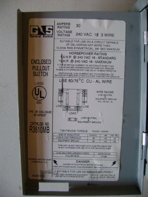

Hello all,
I have my AC comp. with an outdoor disconnect (picture attached), and the darned fuses keep blowing. Have had problems on and off for a few years, every few weeks or months it would blow. They are the time delay FNR-20 fuses meant for motor protection. Well, today I've gone through about 8 fuses, it blows every 30 minutes or so. Only the replacements go, so I am thinking that I probably have a bad batch of fuses. I even changed locations with the one that hasn't gone, and still, the replacement goes, not the old tried and true that has been in there working fine for about a year. I think it has something to do with dirty power here in the house, the fuse often goes after a slight light flicker. Flippo construction is a couple blocks away working on undergrounding of electrical lines, so my guess is that it is sorta Flippo's fault. So I am wondering, can I replace this outdoor device with a breaker type enclosure? Also, the box states 30 Amp, but I have two 20Amp fuses in it, this doesn't see right. Shouldn't I have two 15 Amp, or am I mistaken and should have two 30 Amp? The Comp.'s CB size at the main panel is 40 Amp. Thanks for the advice.

On the side of the AC unit will be a name plate that has Minimum Circuit Ampacity xx amps and Maximum Fuse Size xx amps. The xx will be a number.
If the unit calls for a 20 amp fuse and the 20 amp fuses are blowing it is time to call a AC technician.
That fused disconnect is designed for a MAXIMUM of 30A, but if your A/C unit specifies a smaller fuse, you can use it. You just can't use a bigger fuse than either the compressor unit specifies, or the box is rated for. For 240vac, you need each side to have the same size fuse.

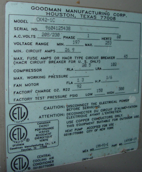

Here is a quick shot of the plate from the side of the compressor. It looks like no matter what a 20 Amp is under sized. Am I correct or just badly misreading things? Should I up it to 30 since the disconnect will support it?

I'm surprised that it didn't blow fuses all of the time, especially if the voltage was a little low. It does say up to, what, 45A breaker?

20A fuses are definitely underrated, the slowblow must have been saving you. But I question why there were 20A fuses in the disconnect? Can you see what gauge the wire is?
KD
207
The minimum fuse size is 26.9 and you are surprised that you are blowing 20 amp fuses???? Hello, you need to install 30 amp fuses now. If you continue to have nuisance tripping with the 30 amp fuses, you can increase up to 45 amps, with a new fuse box. Do you need a new compressor? Depends on how energy conscious you are. There may be other stuff that will save you more money per capital outlay.

I have a similar situation. AC/Heat on the roof. Fuses blow after a couple of hours. Have been replacing fuses with FRN-R-40. But since the original post I see that the min. circuit amps 49.0 and max fuse amps 60.0. Could the reason the fuses are blowing is because they are below rated at 45 amps?
The electrician at the local hardware store recommends FRN-R-60 amp fuses.

The minimum circuit amps. is 49.0 and the max fuse amps is 60.0
The margin seems to be 'tween the 2. Where would 60 amps be a safety issue?
The AC is working fine now
So it seems to me that the solution has been found
Probably it hasn't.
Just check that 60A doesn't exceed the ampacity of the cable that connects your unit to the supply. The cable insulation temperature rise above ambient at 60A will be 1.5x that of 49A so its life may be shortened.

Most likley you're fine. I think your post is being confused with the OP.
MCA=size of wire.
Max Overcurrent=size of fuse or breaker.
What guage wire is feeding your compressor?
