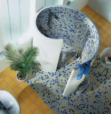

You might look at some of the Wedi kits...they have more than one that is explicitly designed as a tileable freestanding shower. www.wedi.de The one I particularly like is the spiral...no door, although I suppose you could add one. These are made of thick, high density foam with a special cement coating to stick the tile to. They're completely waterproof and have been in use in Europe for quite awhile. You could buy their panels and wing your own if a kit didn't suit your purposes. Basically, you'd discard the stud walls and build it with their panels instead. They come in various thicknesses, and as noted, some of them are quite curvaceous!! Actually, kind of sexy.
