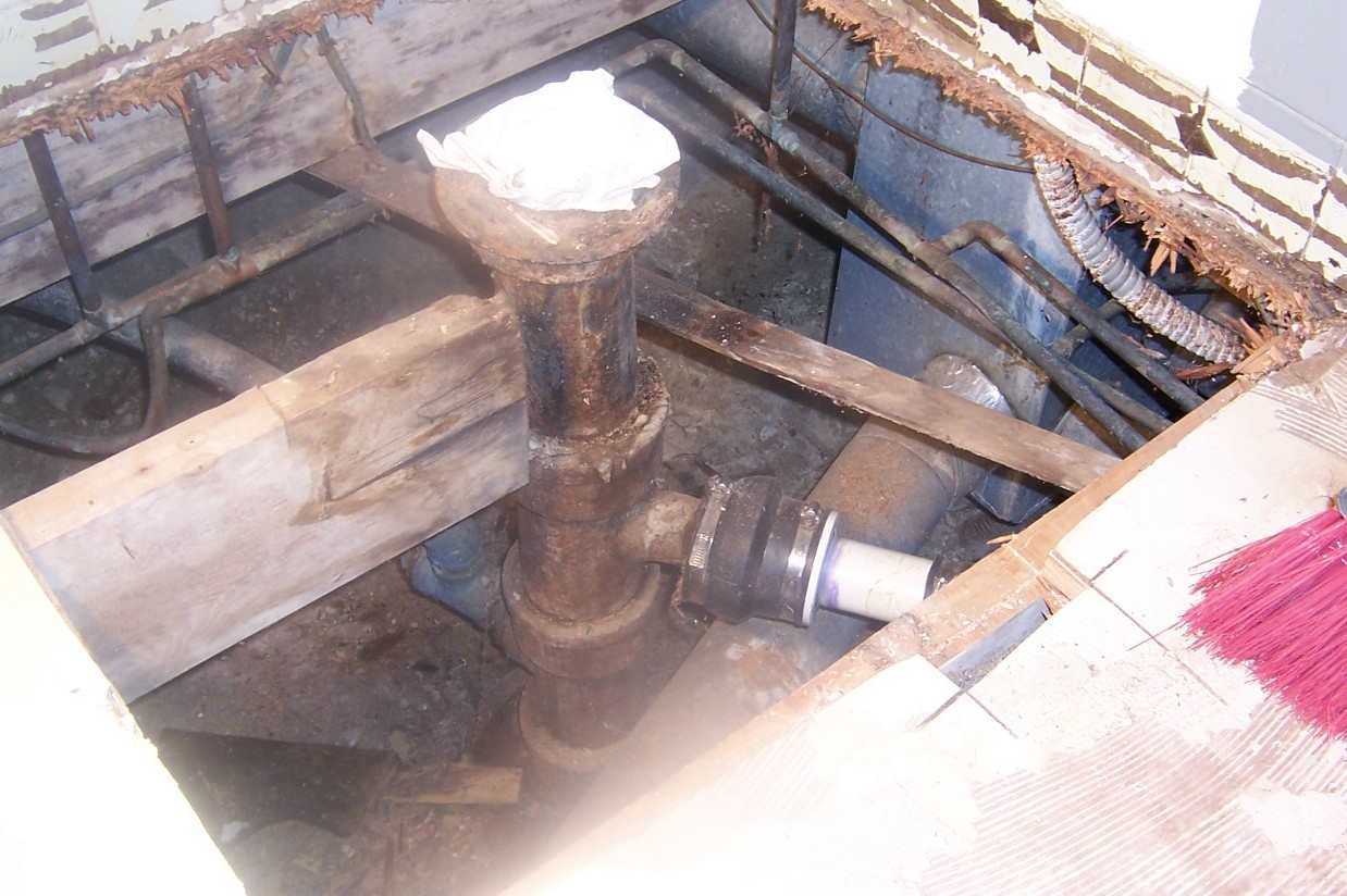

I cut this hole in the floor today when I realized the floor was sloping under the toilet, and it was all rotted. The toilet had been leaking, and the floor joist was cut in front of the drain-pipe with no other support built for it!
Questions are:
1. The cast iron flange still appears to be solid, should I leave it or replace it?
2. If it needs replacing, what material should I use, and how should I do it? It is a lead and oakum joint set-up.

The cast may be fine.
The wood looks pretty bad.
It looks like "hanger" time.
I'm surprised the toilet hadn't just fallen in the hole.
I guess the cast was holding it up.

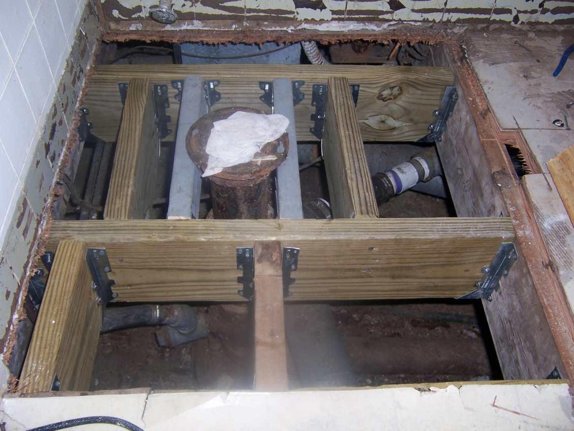

improved subfloor framing
Here is the improved subfloor framing, Please let me know if I should do something different with the framing. I have to get in to the crawl space and install a piece of 2 x 8 under the back wall (where the toilet supply line comes out of). I can't believe the before photo... this is all that was there when I took the rotted sloping subfloor out!

That thing is framed like ya read about...just one problem..
Is that PT lumber for the joists?
I'm NOT a builder, just a plumber, but I think PT's not supposed to be used indoors due to the chemicals.

Good points,
Yes, I have to screw the Cast Iron flange to the boards, and yes it is pressure treated. I wasn't aware of that restriction, and it makes sense. Although there are areas (The Bahamas is one) where presssure treated is required, it may not be accepted here in New York State because of the chemicals. I'll have to check the code.

i thought so too; i liked it. In a small space, it is the right kind of overdoing it, not too much and not useless.
BTW, since it is so strong, and since the pieces are short, the warping that PTL does when drying out indoors won't be as bad as otherwise.
but i'm not a wood frame person, and not an expert.

Didn't think of the PTL warping issue either, good point David. I used 13 joist hangers in this system. Funny thing is, I thought they were all neccesary. Another piece of 2 x 8 with two more hangers may be going in along the back.

One point you should maybe be aware of regarding the treated wood. The currently available brown stuff will attack galvanized steel in the presence of moisture. They make extra heavy coated steel for use with this wood (or stainless). Maybe you could give the new work a while to dry out a bit rather than trap the moisture in there. If it is new wood it is probably pretty wet from the treatment. I would not worry about inside use. Most places require any wood in contact with concrete to be treated. So any inside framing against your foundation is treated wood.

It's true. The new pressure-treated (ACQ) eats electrogalvanized for breakfast. Seems the active indredient is copper, so electrolysis kicks in the minute anything gets wet.
Manufacturers are recommending hot-dipped galvanized at a minimum. Grace has a self-adhesive membrane you can wrap the wood in, to keep it from touching the metal - not too sure how that's suppposed to protect the fasteners, though.
