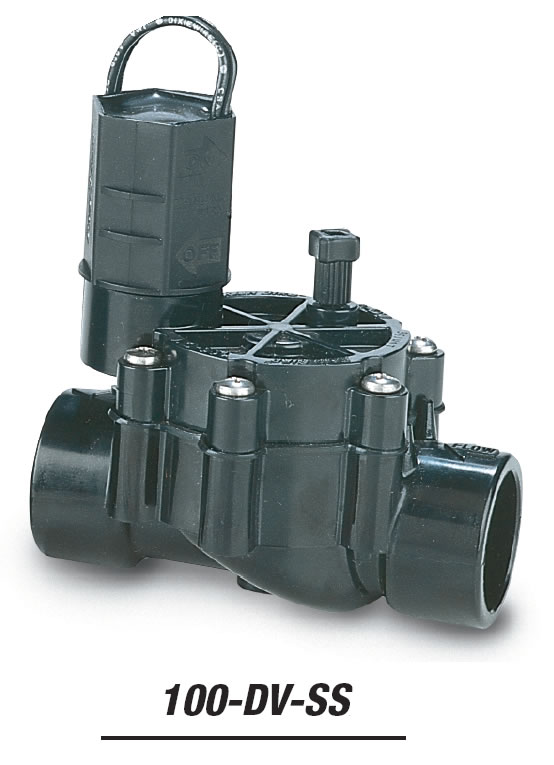

    Each valve has two wires connected to it. One is the common or ground wire comes from the common or ground lug on the controller, and is daisy chained from valve to valve. It is usually a white wire, but a DIYer may have used some other color or colors. The hot wire comes from the individual posts on the controller and each valve has it's own wire. I don't know what you have found in the box you looked in, but it doesn't sound like a valve box to me.
    Here's what the valves should look like:
    Check all the valves for loose wires. You may have to remove the wire nuts, since it probably won't be obvious.
    I think the valve with the lever is just a ball valve that is in the "on" position. This ball valve probably lets you shut off water to the irrigation system.

    The pictured valve was a Rainbird valve. Note the two wires at the top. You may have another brand of valve. If there aren't two or more valves in a box, then you may have trouble easily seeing which wire is the common.
